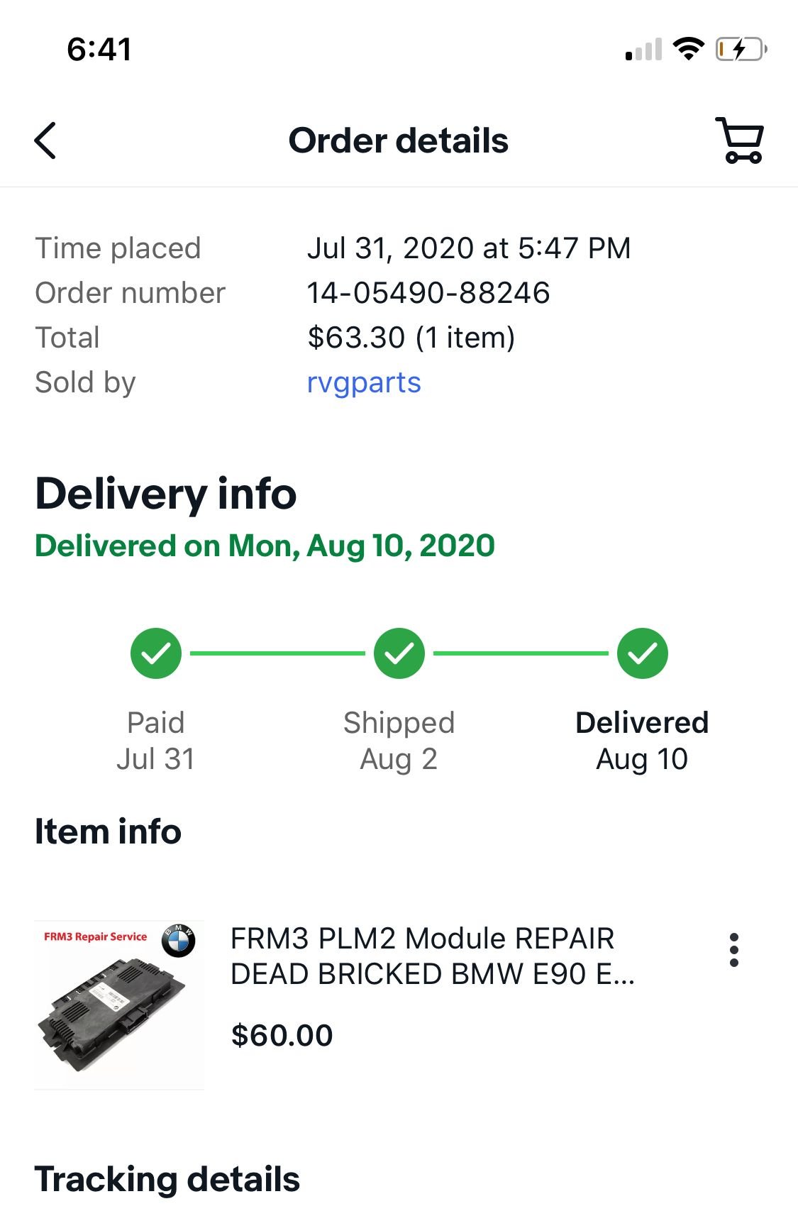

Continuing to “plan b” I sought out places online that offered to reprogram the FRM. After searching a bit I found a seller on EBay by the name of RVGparts. So I shipped the part out with a piece of tape including the last 8 digits of my vin.
So a few days passed and the reprogrammed FRM was shipped back. I installed it the other day and sure enough my fog lights, windows, and blinkers work again! What a relief saving some $900! However when I plugged my C110+ bmw scanner up to the car I did have a few faults including the FRM. Not sure if these are stored on my car prior to replacing the FRM and can be erased or if I need to go back to the drawing board?
