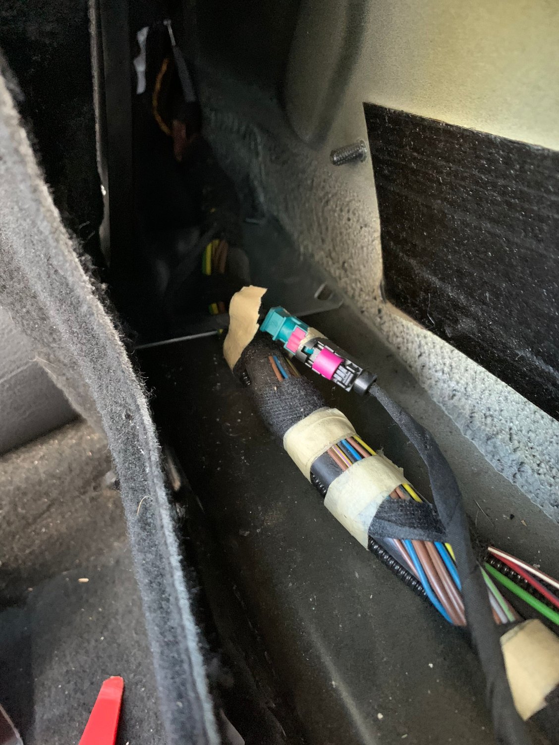

I installed a set of bc coil overs today. The rears came with extensions so I can remote locate the adjustment dial. Has anyone installed these? How and where?

To fit the remote adjusters you have to drill a hole in the wheel arch,this is in line with the top of the shock so that you have a hole that comes out in the boot area then you can fit the adjuster to the top of the shocker and thread it through into the boot.Hope this makes sense.

ok. I understand drill a hole right above the shock. You lose me at boot. Lol. Is that in the trunk? Or still on the outside of the car?

Be careful, there are wire harnesses above the rear shock mounts. If you're not careful, you'll drill right into them.

Sorry i forgot you call the boot a trunk over there also as Njaremka says be careful of the wiring.

Thanks for the help. Panels out. I have a few metal plates I’ll use to protect the harnesses, that are directly in the line of fire. Lol. Tomorrow after work job.
