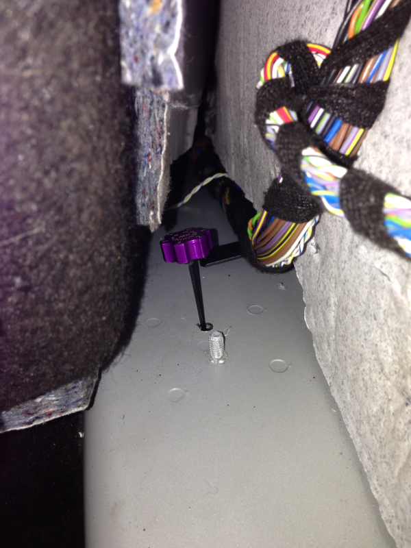

Coilover Rebound Adjuster from Inside Boot
Has anyone seen some kind of tool (or made one) to permanently mount in the boot of their MINI to adjust rebound settings on their coilovers? I want to drill as small of a hole as possible to access the top of the damper but don’t necessarily want to reinvent the wheel. I’m not sure if a really long 2mm allen key will reach the top of the damper if I drill a hole. I know I’ve seen these at the track on some Mustangs and Vettes with these long springy adjusters that are elegantly positioned in the trunk. BTW, I have KW V2 coilovers.
Taking the damper out every time for adjustment is just silly when you can just open your boot and fiddle with a small adjuster on the inside.

I drilled some pilot holes when I had the rear coilovers out this winter. The distance between the top of the coilover adjuster and the interior sheet metal doesn't seem to be that far apart. Maybe an inch or two. Now for the hole saw...

This is what I just did:
I used a 3/4 socket extension with some tape wrapped around it so it was tight when I fit it through the dampening pad.
I put a bit of red plasti-dip on the end and slid it through and made s mark on the underside.
Then I took a 2mm ball end Allen and swapped out the one in the dial that came with the KW kit.
I have a Coupe, so thus is how I can access it without being too intrusive. Just taken out the tabs and pulling the panel out, the grey box needs to come out on the passenger side too.
I also modified my jack holder to hold the KW Kit parts.
