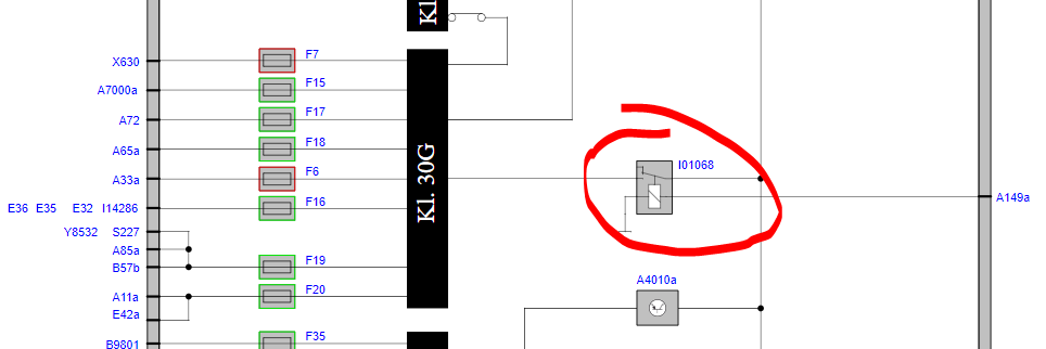

I've searched through the Bentley Manual but cannot find which relay this is on the footwell fuse panel. I was checking fuses yesterday and this relay was very hot to the touch. Im pointing to it with the red multimeter lead.

Looks like relay I01068. It's controlled by the CAS (car access system) module and switches terminal 30G which is the power supply for a lot of downstream modules (e.g. the HiFi amp, sunroof, DSC, etc.). Near as I can tell it's not unusual for it to run warm (it's energized as long as the car is occupied).
And a snippet of the A4010 wiring diagram:
