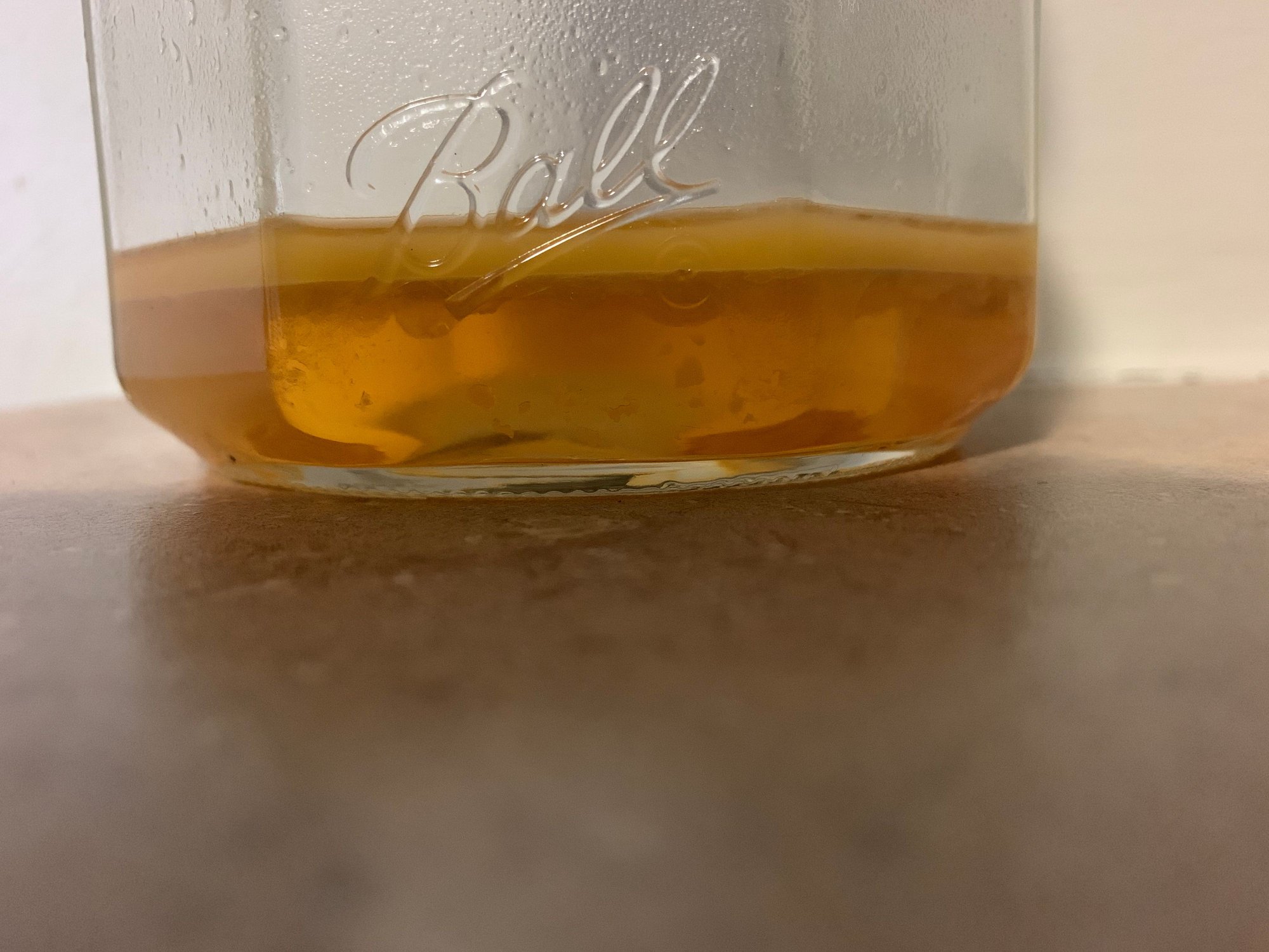

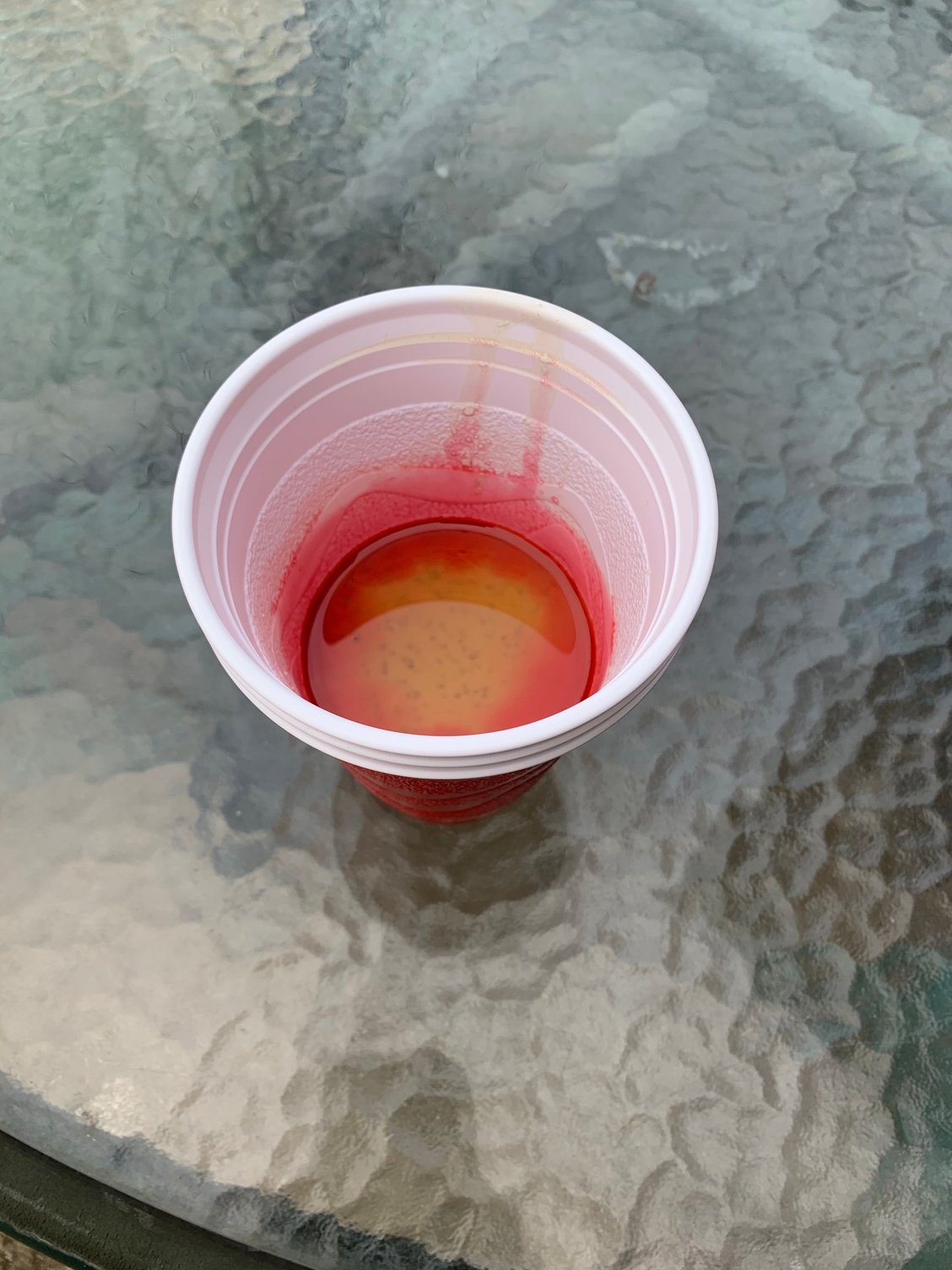

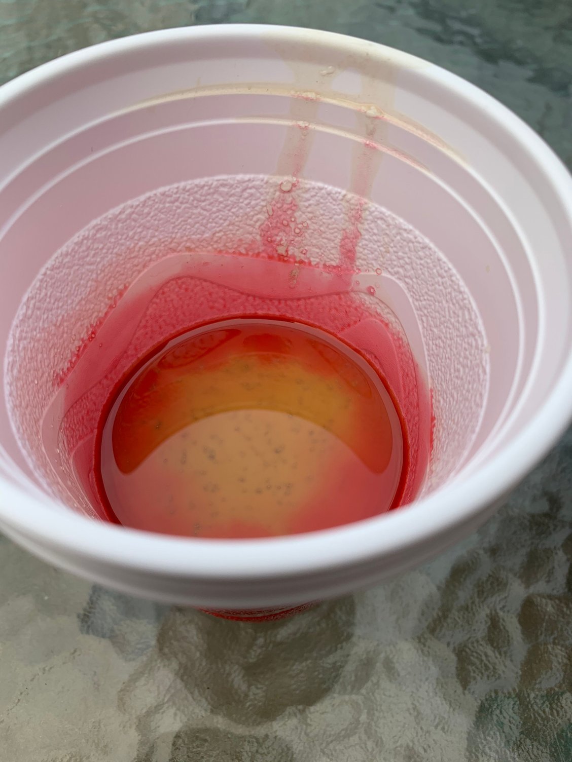

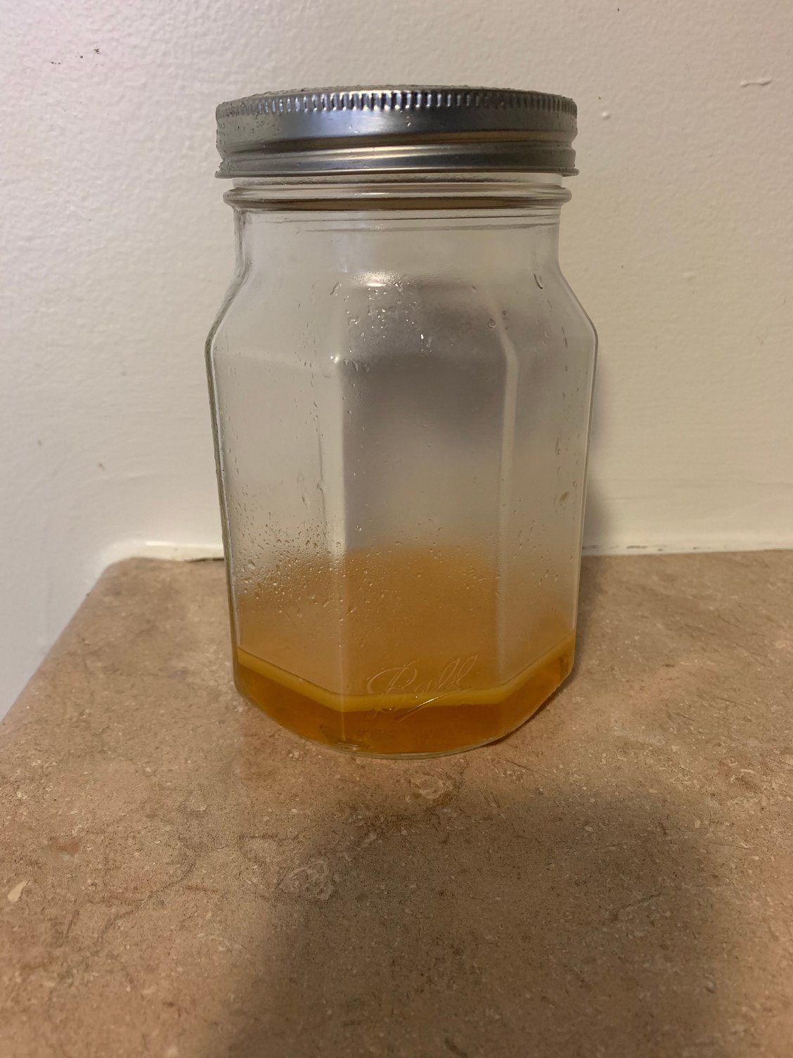

I have mine blocked on the passenger side and OCC on drivers side, on the N14.
dont poor into a solo cup, first time emptying it
This is after 600 miles
I know that you wont be able to tell how much that is, so i have been keeping track of it and over the last 8000 miles i have collected half a qt of this.
