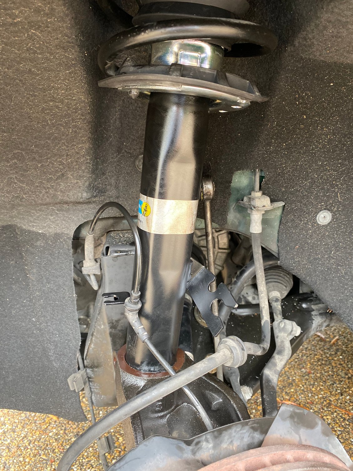

So I test drove it down the neighborhood street, and both front left and right now clunk. Not sure what I did.
Is it safe to drive to a shop?

Originally Posted by Frixos
Ended up hammering the bottom of the knuckle with a big ole hammer and it slowly but surely made its way up! Thankful for this project to be done.
Since this sounds like the most challenging part of the install, perhaps it was not fully seated.

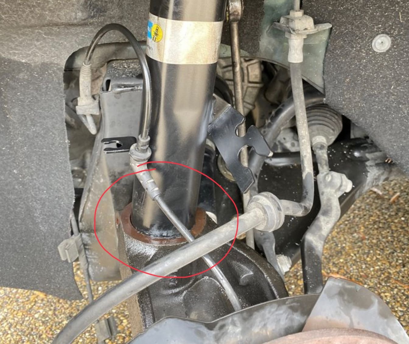

Could you elaborate on what you mean by not fully seated?
Sure in the image below. Perhaps the bottom of the strut was not fully inserted into the control arm (circled in red below. I believe this is what you were referring to as challenging in your first post. If it in not fully inserted and tightened, just the slighted metal on metal movement will make noise.
