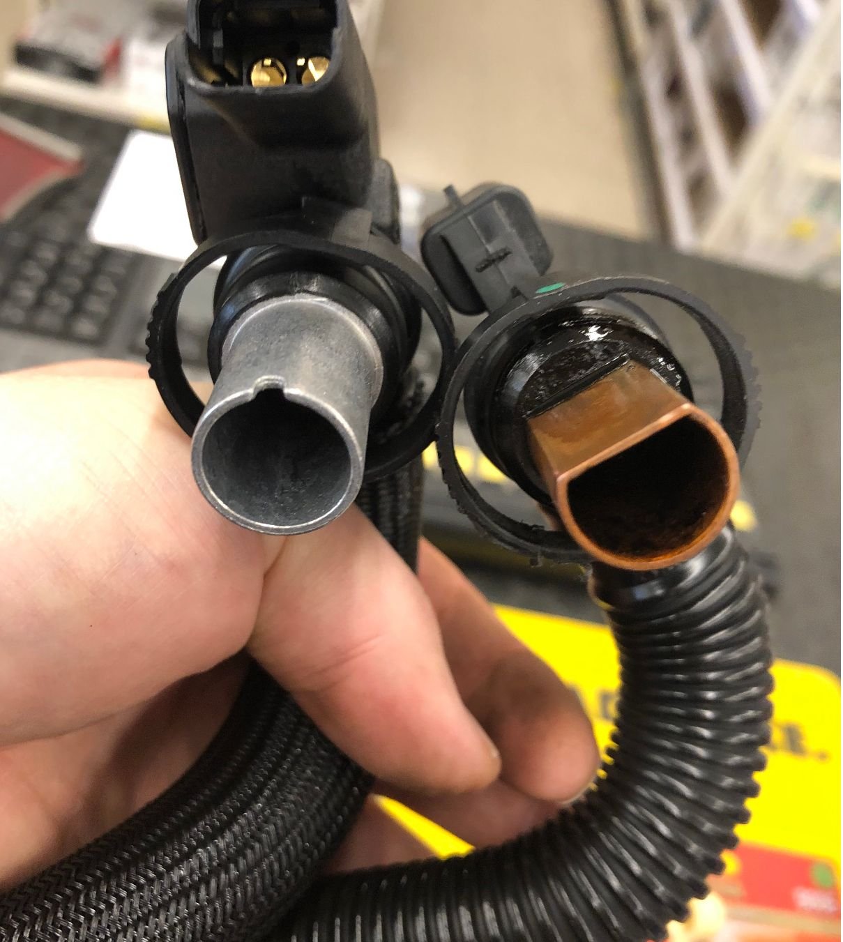

Anyway, here we goon the breather: The breather hose I have that runs from the PCV to the underside of the intake manifold and does not exist according to the two Mini dealers in my area (Allentown, PA and Otto’s, West Chester, PA where the car was originally purchased). The original is on your right below and the one Mini is convinced goes to my car’s serial number is on your left.
Our solution was to purchase about a foot of 3/4 inch radiator hose and connect the original two ends. Has anyone else done the same? I am a bit concerned that the tubing may wear through vibration, heat cycles or collapse from vent pressure. In our eagerness to get the car on the road again and thinking we would be okay, we just rigged it together. Insights or experiences are appreciated.

They had an update on that hose talked about it here: https://www.northamericanmotoring.co...ng-dealer.html
Did it not work or fit right?
Glad you were able to get things fixed. Looks like you are coming along well with the MINI.
Reply 0
Oct 30, 2019 | 07:56 AM
No it did not fit. The link you provided above did not work for my car either. It is the same part two dealer’s recommended for my cars VIN too. Something is missing here. We had to just use 3/4 inch hose and are hoping it does not collapse. The main issue is the electrical connections are on opposite sides. The connector does not reach the new part and there is no room next to the intake manifold for it.
Reply 0
Oct 30, 2019 | 08:14 AM
Huh, other guys said it worked? Its for that 2007-2010 N12 engine, which is what you have. That link is for your MINI. Do you have pics of what did not fit or work? First time I have heard of this,, just trying to figure out as it does not make sense. People would call and tell us, then I would report it to my inside MINI reps.
Any pics would help. Show the old part next to that new part in length.
Reply 0
Oct 30, 2019 | 10:26 AM
Quote: Huh, other guys said it worked? Its for that 2007-2010 N12 engine, which is what you have. That link is for your MINI. Do you have pics of what did not fit or work? First time I have heard of this,, just trying to figure out as it does not make sense. People would call and tell us, then I would report it to my inside MINI reps.
Pics are in the first post. The original in on your right and the one from Mini is on your left. The one in the link you provided is the same as the one that does not fit.
Reply 0
Oct 30, 2019 | 10:31 AM
Original on your right. Dealer unit on the left
Reply 0
Oct 30, 2019 | 11:22 AM
Got the length side by side?
Reply 0
Oct 30, 2019 | 12:10 PM
Length is the same. This is the only other pic i have:
Reply 0
Oct 30, 2019 | 12:44 PM
Thanks, length of the total hose, so i can see if there are problem.
