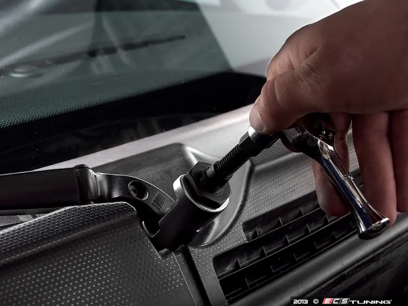

So I bought the replacement cowl pieces. It seemed like a simple project to replace them so I went out to do it this morning. I had a problem right off the bat. My wiper arms are stuck! I tried wiggling them but not luck. I'll go out later and pick up some penetrating oil and see if that helps. Anyone have any other suggestions on how to remove the arms?

it's not necessary to remove the wiper arms. I just removed my cowl pieces without doing so. Just work slowly and carefully
https://www.pelicanparts.com/techart...eplacement.htm
Old Mar 10, 2020 | 10:55 AM
Posts: 36,767
Likes: 2,553
https://www.northamericanmotoring.co...ield-cowl.html
Its the other side when you do the whole cowl.

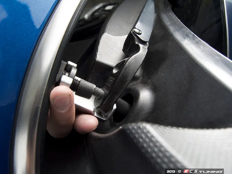

Hit it withe some free all and let sit or get a wiper arm tool.
https://www.ecstuning.com/Search/SiteSearch/wiper_tool/
My wiper arms were "stuck" when I first tried to remove them too. I might have it wrong, but they released fine when I pulled them fully up. I tried testing it out, and when the arms were flat on the glass, they would not come up. When they were pulled fully up (so bent as much as the hinge would allow), they slid off easily.

A wiper arm puller did the trick!
This whole "quick" project has been a pain in the butt though. I can't get the new pieces to sit very flush with the windshield. The rubber piece that was glued along the bottom of the glass keeps sliding when I put the new cowl pieces on. I got it close...but not close enough for my liking. Anyone that's done this before know a trick for that? I messed with it for over an hour. I'll try it again tomorrow.
