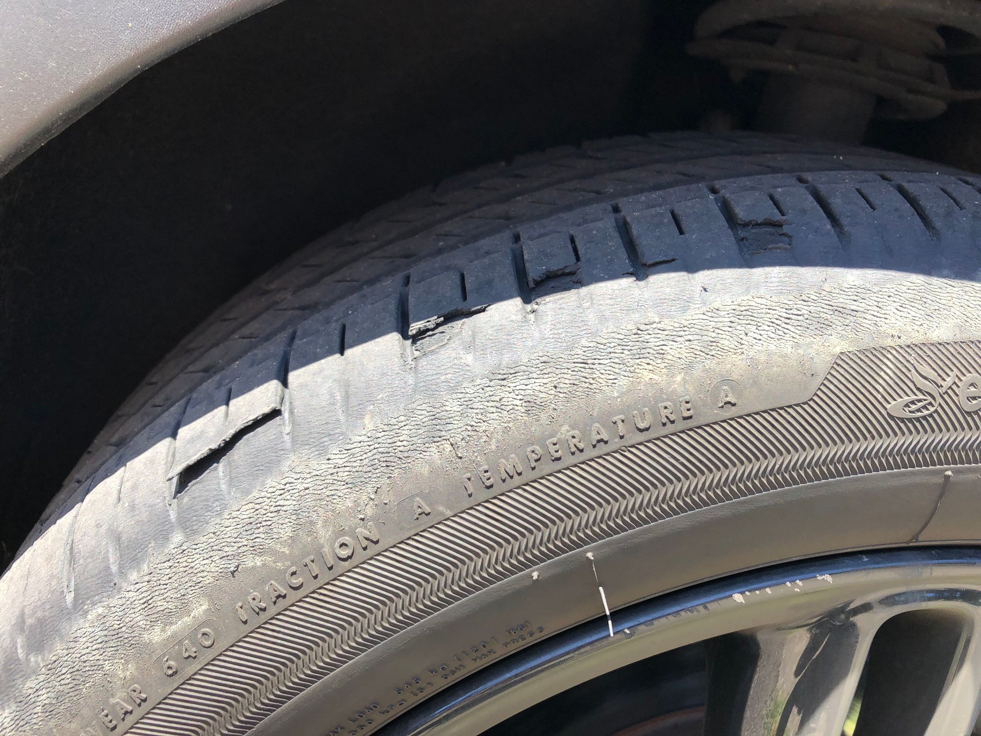

I'm a newby. My Mini is a daily driver and I don't want to totally MOD-OUT my car, which is a totally stock, 2012 COUPE "S" with 15mm wheel spacers that I'm not married to. I understand that the wheels and suspension of the R58 and the R56 are essentially the same and there are a LOT more R56 owners than Coupe owners so I'm posting here to have a bigger crowd to source. Please forgive me if I am mistaken about the similarities between the two cars.
I just spent a few days at, "the Ridge" track in Shelton Washington, (first time on track). Had a blast! Want to do it again.
That said, I learned in the process just how bad the tires on my car were, (Bridgestone Ecopia EP422 Plus). See photo below...
I want better traction than I was getting at the track and understand, "Contact Patch" to be a big deal. So I'm on the hunt for new, wider tires.
My thought is to get the widest tire I can fit on my mini without dropping diameter too much, or cutting/ rolling fenders. Can I can get 205/50/16's to fit my rim and car? Can i go wider? I was also thinking of going 215/40/17's but this would require another set of rims, which I'm open to, but i'm not sure the 215's will fit, or the offset required to make them fit. In either case I plan to get a set of ultra performance/ track tires.
What do you all recommend? Make and size please!
