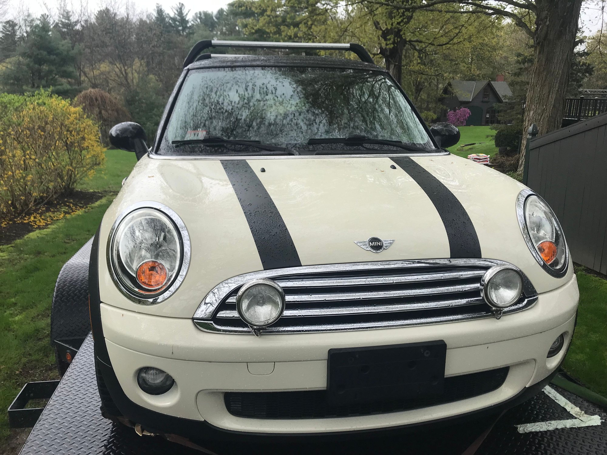

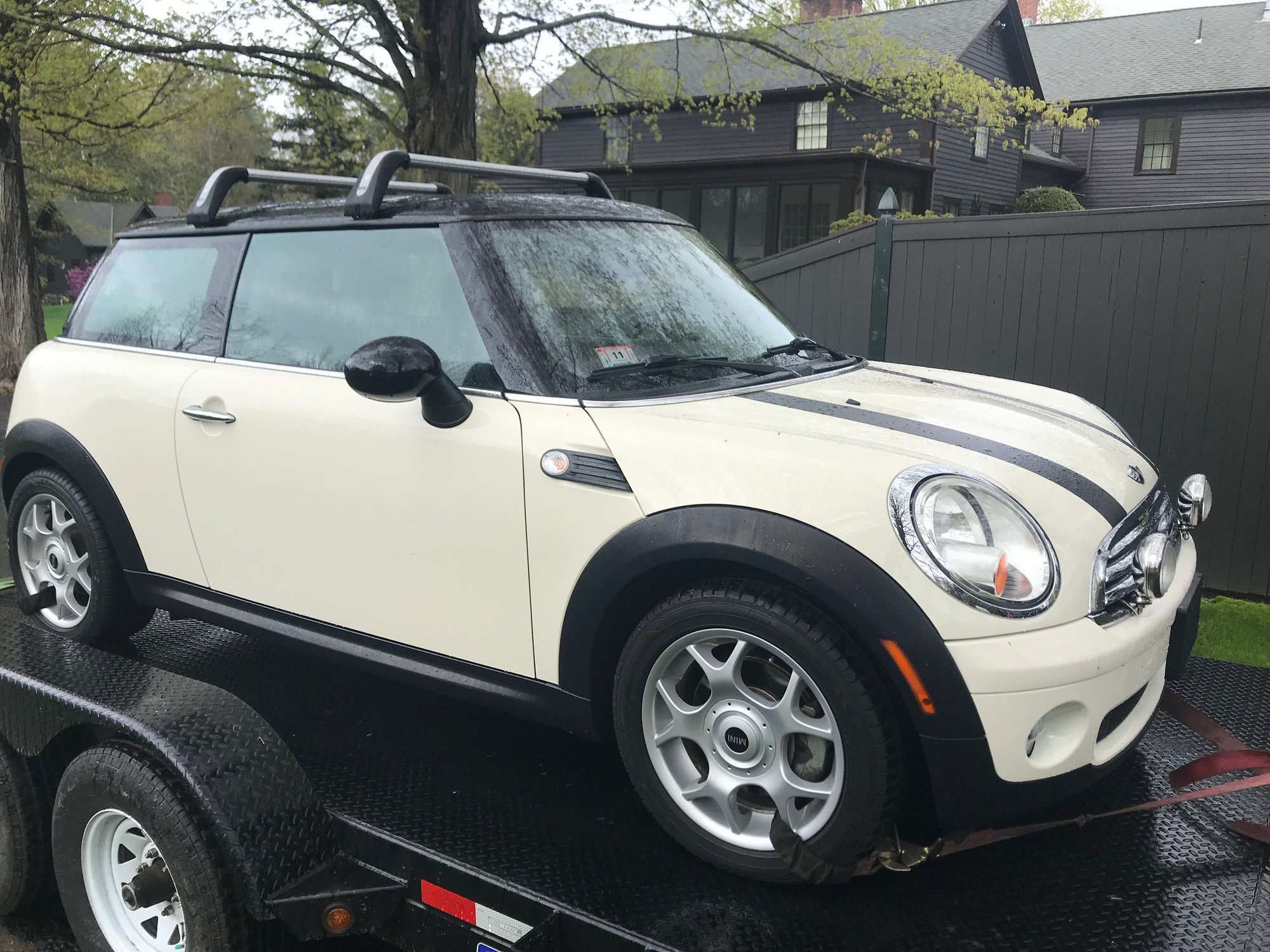

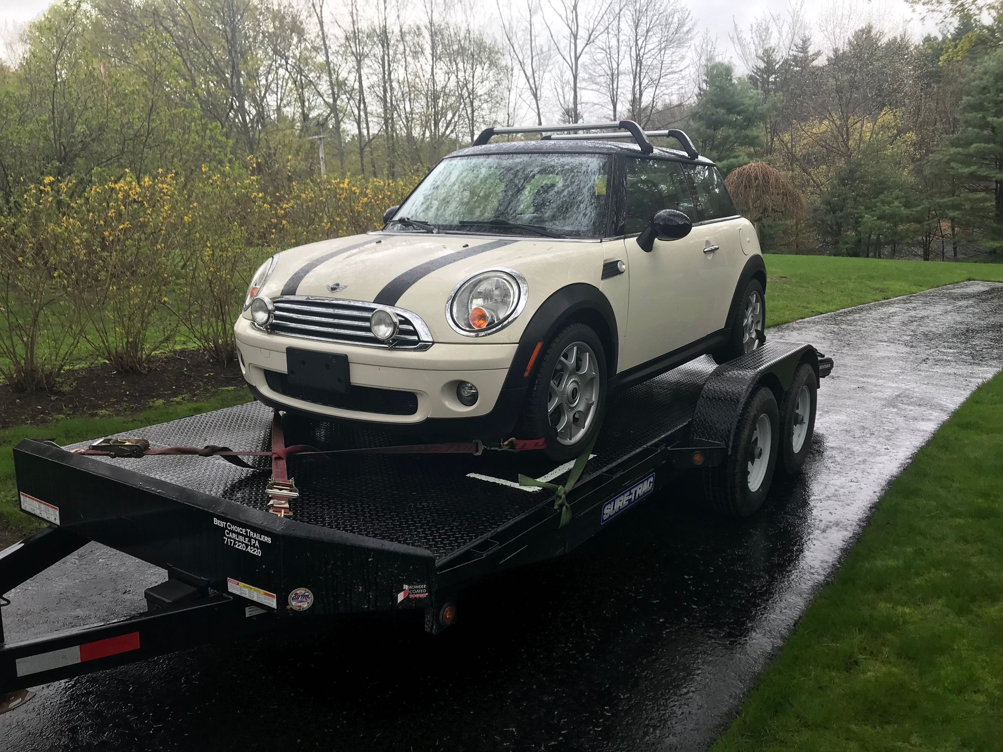

So I ended up pulling the trigger on the 2007 r56. One owner with 60k miles and service history since new. Car was really well cared for and extremely clean.

That looks super clean and someone ordered or installed the old X lite wheels from the R53 era. Nice find.
