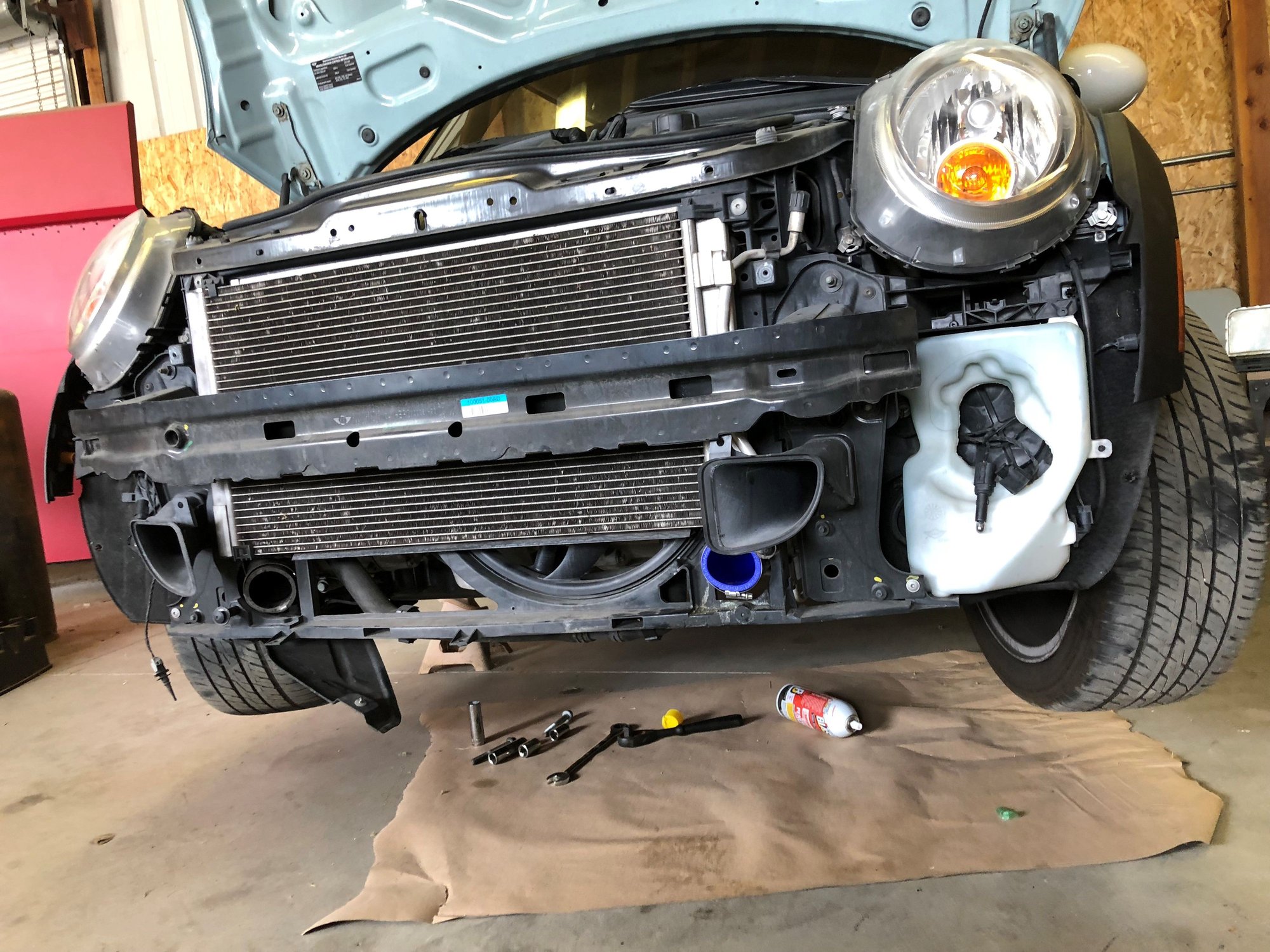

ECU: Has been flashed by Mario (Can't say enough good things about Mario)
Went with a Manic Stage 2 Tune
New Plugs Installed
FMIC in the mail
Forge Intercooler Resonator Delete completed
Plasti - Dipped all the Chrome on the car
* Side note to anyone else looking to remove the resonator from the turbo to the intercooler. The muffler has a T20 bolt holding the hoses and the muffler in place. This little guy is quite the mother effer to remove. It will test your patience. Keep in mind this is a 2012 MCS and it required a T20 (I had read T25 elsewhere) I ended up jacking up the driver side of the car and climbed underneath. Once underneath I could at least see the damn screw/bolt. There is a hose clamp blocking it. I did my best to loosen the plastic pieces holding it in place so I could push it up and towards the drivers side wheel. Once it was out of the way I used a ratchet with an extension and one that had a little swivel in it. Had to hold a flashlight in my house and play the nightmare game of can I get it up into the bolt before my arms turned to Jello. After about 10mins I was able to get that little bastard off. Total pain in the ***.

Latest Update:
For anyone attempting to install a DP in the future. Please don't start in on the project until you are at peace with yourself for the day. Removing the heat shield is a total pain in the ***. No sugar coating this. You have to have patience and have the right tools. If you are limited on the tools, I would maybe suggest placing the car in FES mode so you can gain the extra few inches you need to get your hands down in the tight areas. I used a small air ratchet with some swivel sockets and it was a challenge.
For the re-install I ordered some Heatshield Lava Wrap and omitted installing the lower factory heatshield. Getting the DP back in was definitely a tricky process as well. Like all cars once you understand the steps to place it back together it gets easier.
I would highly recommend the DP from Mario Kart on these forums. If you need customer service or help, he is right there to answer your questions and he has done this work himself so he knows what challenges you are probably experiencing.
Long story short after some cussing a some trimmed brackets (Not the DP) but the brakets that hold the DP I got the DP installed, with the heathshield wrap and I installed the upper heat shield.
Now I am just waiting for the FMIC to arrive and I will have this little project back together. After I get to test drive it for a day or two it will go up on the trailer and be ready for it's journey into Idaho where the work will continue.
I highly recommend getting the R56 up as high as you can to make your life easier when attempting the powerflex bushing and DP install
