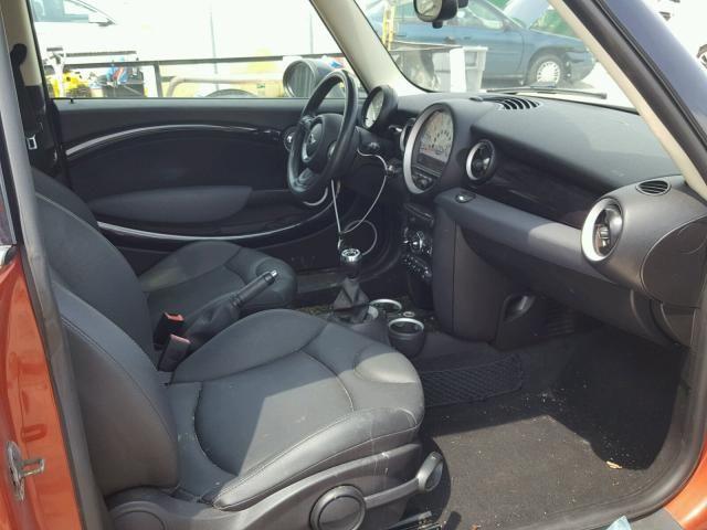

just FYI, i just picked up a 2011 MCS manual with 83k miles I will be flipping. let me know if you would be interested in it

N18 on that flip right? Looks like a smarter choice minitobe! Not my favorite color but looks like a nice car.

yes, this is N18 engine...I wonder what could be the issue? but I have an engine sitting that I can just swap and then dissect this one...lol
I love N14 engines and I love working one them...I just grab what I can potentially make a buck and so far so good. I drive all my flips for at least 3k miles and change the common failure parts even if they're ok so the next owner doesnt have to worry about it.
