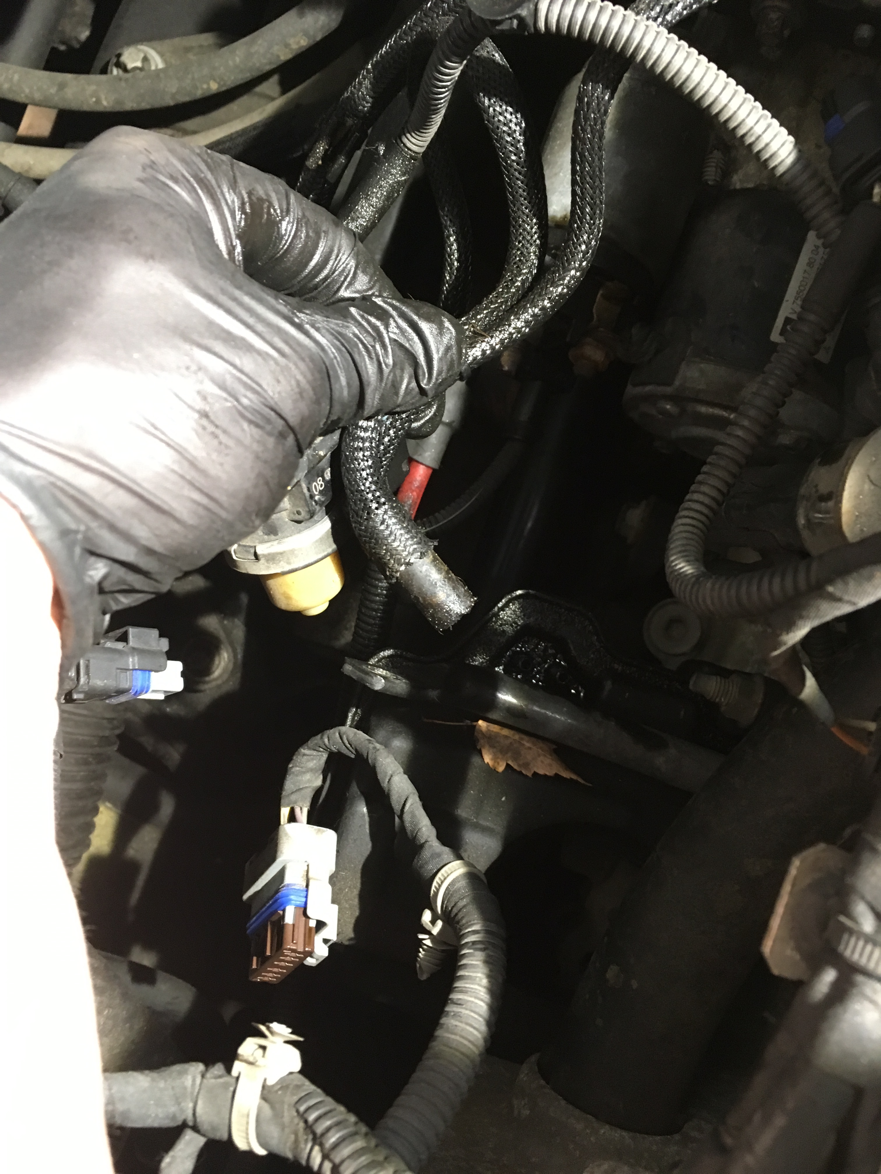

Well I'd say I found my problem. The vac lines weren't even on the vac reservoir! The lines were all swollen and oily so I replaced them. This area is quite a pain to get to by taking off the intake manifold - and that one bolt on the bracket underneath required taking off the passenger wheel and a super long extension with a flex-head, and then the paper towel trick to get the bolt back on. Intake looked decent so I didn't even clean inside, just the mating surfaces. I replaced the intake manifold gaskets, buttoned everything up, cleared the codes, and all is clear now. Car boosts like a champ, wow!
