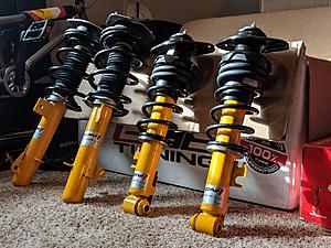

Just re-did my stuff all away around ! Was about 2000ish
All new
Koni sports
Eibach spring
Oem front mounts
Oem upper spring plate
Oem rear dust cover
Oem guide support rear
Oem spring plate
Oem spring guides
Power flex black/series
Rear shock tops
Performance Polyurethane Bump Stop Set
Sway bar link bushing
Rear trailing arm bushing
Attached Thumbnails rear suspension replacement help-e7839925-9d07-4d27-a523-78cab8fc5f61.jpeg

I really like that picture

How low is it with that setup and how is the ride quality? Also what spring rates? I’m thinking of ditching my bc racing coilovers and going with the Koni/Eibach setup on my 200mi+ a day daily driver. It seems like I spend more time watching out for pot holes than actually driving.
