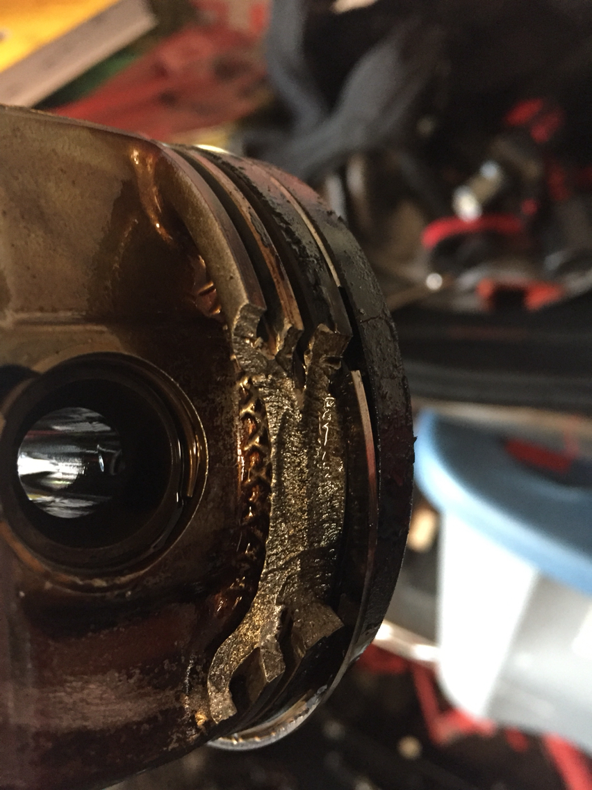

I've got the same problem with my 2007
MCS. I did a compression test and found weak overall compression and one cylinder none. After I tore the engine all the way down I found a piston with the bottom ring land broken off. Lucky no cylinder damage.
