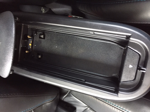

My wife and I just purchased a 2013 Mini S Bayswater this past weekend. We totally love the car!
The car came with a snap-in phone adapter in the armrest. I can't see myself ever using that. I'd like to take it out to free up space, but I'm not sure how to do that. I don't want to end up breaking the armrest. I've searched for installation instructions, thinking I could do them in reverse, but I can't find anything. Does anyone here know how to get that thing out?
By the way, this is the armrest I have: 51169241205.
Thanks!

I did notice that the lid flips up. And I did get a little piece out (see pics). Maybe mine didn't have the actual adapter and this is all the room I'm going to be able to make. I thought that since the armrest is so thick that there must be a way to reclaim that space. Maybe not.

In case you were still trying to figure it out.
1. Slide cover back
2. Pull up on cover so it tilts back
3. Push the big button at the front of the arm rest
4. Lift snap in adaptor from the back side and it will come right out.
They made it like a puzzle... Ha.
