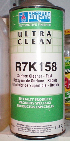

that tape is pretty good so long as it is applied to a very clean and smooth surface. Did it come with a 'prep wipe'? If not I'd clean the area well with regular wash, then rub down with alcohol unless you have a friend who has some of this:
but you mentioned cracking and paint bubbles so I'd sand to get all loose paint off, then smooth with 600 grit ... then clean. And I'd consider a lil superglue on the crack ... smoothing any residue here as well ...

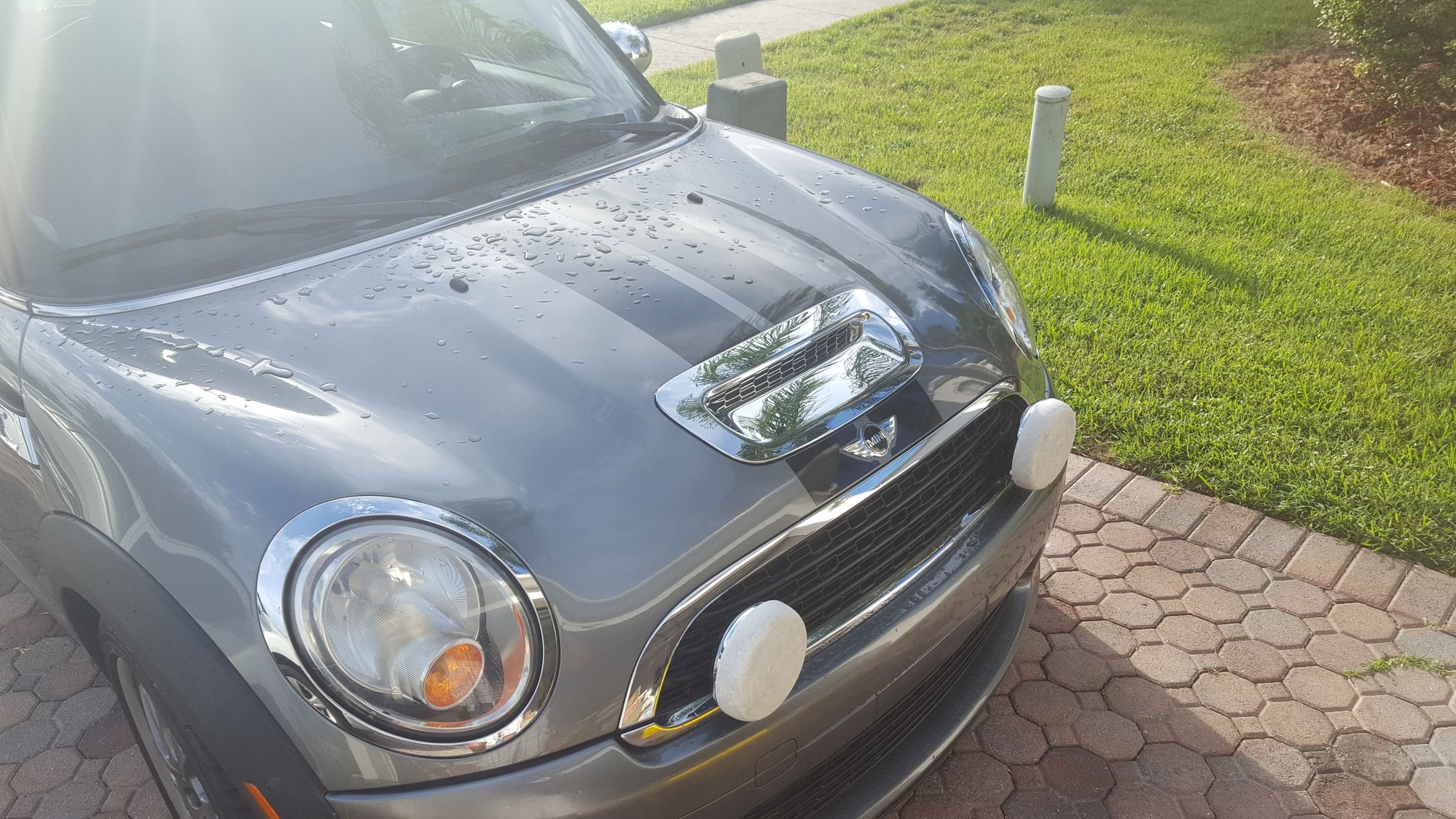

Sorry, what I meant to ask was if the double-sided tape was enough to keep it from flying off.
Should i remove the paint off the old scoop too?

OK, I just finished placing it. I pushed down as hard as i could and held down for at least 7 minutes.
Take a look at the pics and let me know what you think.

It looks nice. Good Job...

Looks good.
