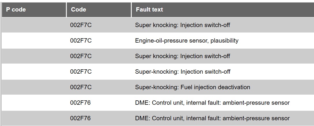

Here is what shows up on Rheingold ISTA Diagnostic tool. Some have details (provided one for 2F7C) while others do not.

I don't know what evil genius came up with these - I count 10 versions of 2F7C (most relating to Super-Knocking, a new term for me) 18 of 2F76 (mostly ambient pressure sensor), and 6 of 2DCE (no message from ASC/DSC or Valvetronic system, no adjustment possible.)
I suppose options are always good, right? But none of these appear to be actionable at present.
Research on super-knocking seems to indicate it may result from carbon build up on the valves. At 60K miles, that's a possibility. Might be a good time to use Techron and valve-type cleaners.

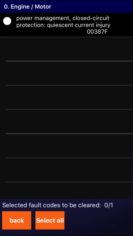

I got this fault code from Carly 00387F, engine motor power management, closed-circuit protection quiescent current injury. Can't find this code anyway trying to figure out what is the faulty parts. Anyone have idea thanks.

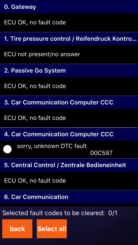

00C587 = CIC Gateway, Sleep-mode/Standby can´t be activated.
Attachment 124506
did you ever figure out how to fix it ? i have the same code
