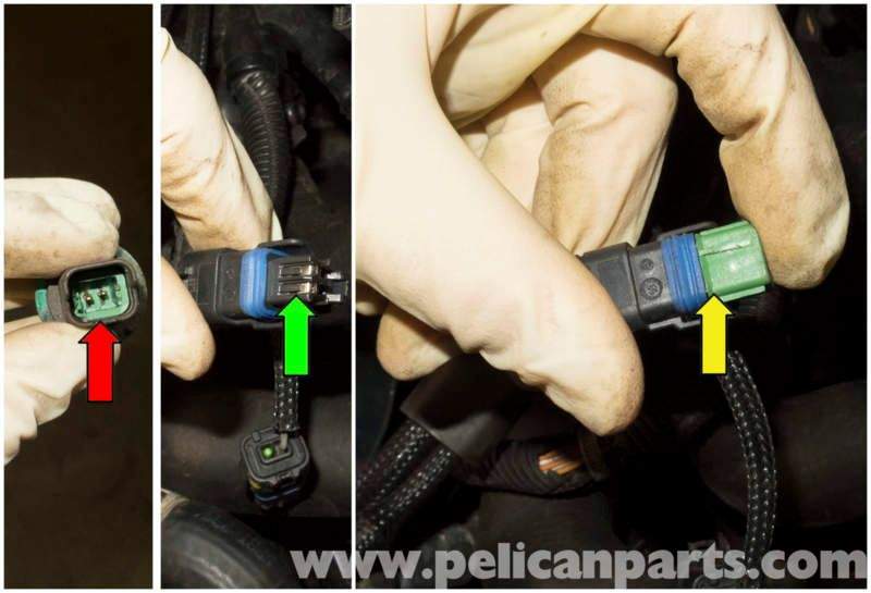

So, I went to go make sure the CTS was in properly. I looked at it and everything looked fine so it must be a bad sensor. But then, I went ahead and undid the clip to the sensor to remove and inspect it. The clip flung off the sensor and now I can't find it or close off the top of the thermo housing. Does anybody know if I could find this at a local store?

Are you talking about the green clip by the brown sensor? (Green arrow below).
If so, it's #7 below. HERE for the part number. If you have a dealer near you or possibly a MINI indy shop, they might have something on hand for you.
If the connectors are plugged into the right locations, then check and make sure there are no loose or damaged wires. Do you have the old sensor by chance? Could plug that one in and see if the code goes away to test your current one.
MINI of Plano, TX sent me a clip for free so shout out to them for their generosity.
I am talking about the green one. That is the sensor. Does a new thermo come with a new sensor? I can't recall if mine did or did not but I am about to go dig through my trash for the old thermo.
Yes, the new thermostat should have come with a new sensor. Pictured below, you can see it on the bottom by the bleed screw.
Most of what I have run across when this code appears after installing a brand new thermostat, it's a connector not being plugged into the right spot, a wire issue, or a faulty thermostat unit.

Well what that means is that the new thermostat I ordered from PP came with a bad sensor. It was OEM.
I have the old one in the trash and I just dug it out. It got rained on, though. I'm going to pull the old sensor and the clip out of it and use those... Currently having trouble getting the sensor out right now... Do not know why.

Using pliers, pull the sensor out of the thermostat (red arrow). If the sealing O-ring does not come out with the sensor, use the pick to remove it from the housing (green arrow).
As an added note: Sometimes the electrical connector cover will remain in the old sensor (red arrow). If this happens the connector will be exposed and not center in the sensor properly (green arrow). Pull the cover out of the sensor. Then press it back onto the connector (yellow arrow).

Well, I bought the whole thermostat from you guys and that seems to function just fine. The P0118 code has to do with voltage to the sensor. I still do not understand how to solve that problem. If that means it's a bad sensor, I need you to send me a new sensor. I do not want to have to replace the thermostat again.
The sensor (new one) is still connected to my car but disconnected from the thermostat. I cannot for the life of me get the clip on it to clamp it in... Need like miniature hulk hands and a perfect angle.
