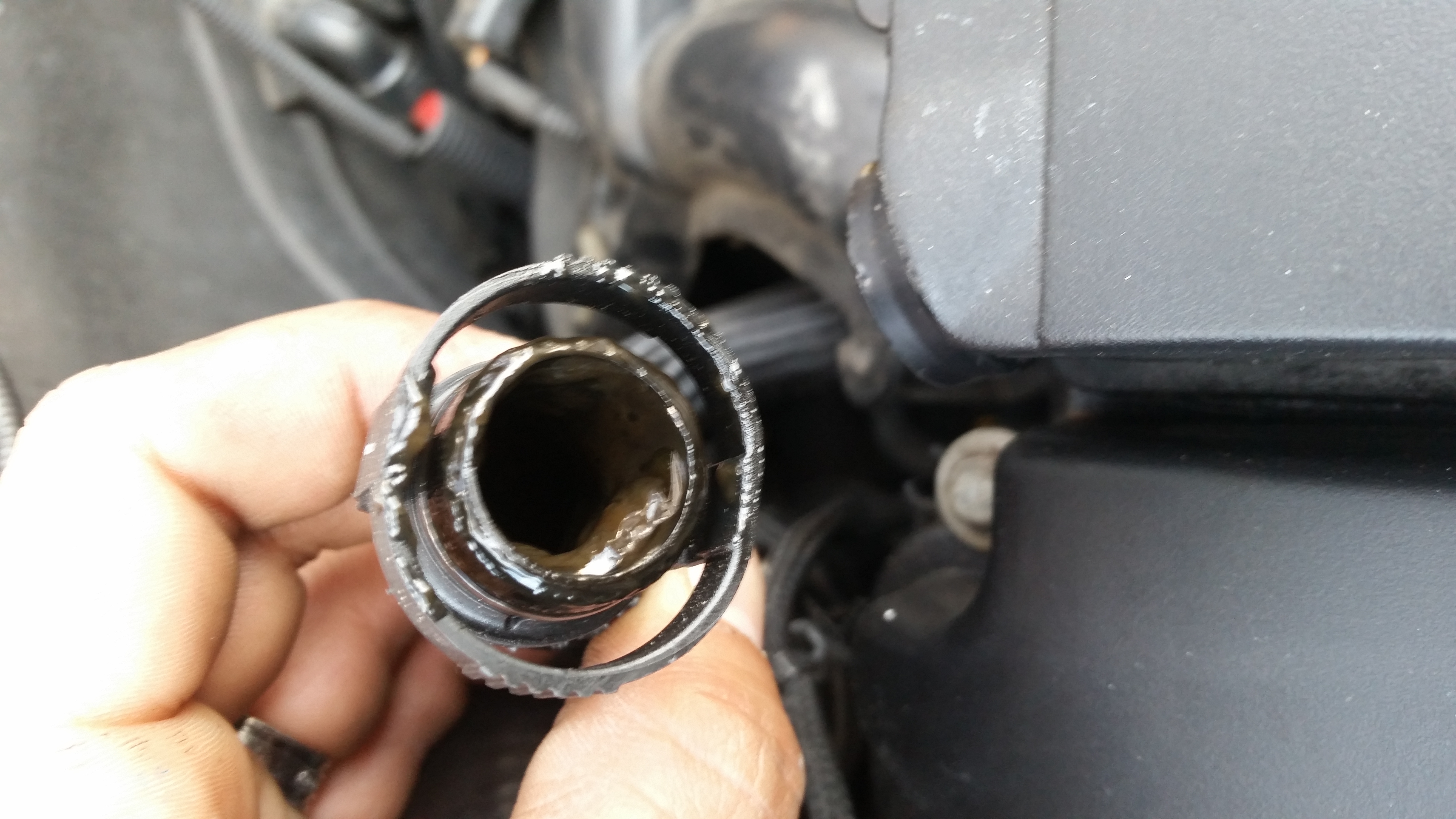

Is this normal? (2007 R56)
Heres a picture.

Yes and no.. what kind of oil are you runing and when's the last time you've had a tune up..???

Your valve cover has dual built in PCV System ( positive crank case vent ) to prevent this ( Sludge ) from happening....maybe it's not fully functioning.
What are your frequency of oil changes ?
Old school = 3-5K miles, my engines always purr like a kitten even after 200K miles.
MINI crazy idea of oil change every 15K ludicrous IMO = I doubt filters can take that abuse / work as well.

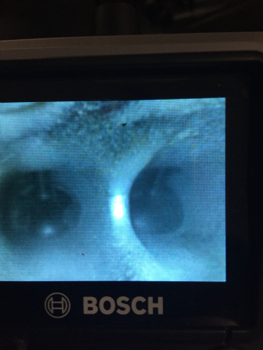

I ca only imagine the valves must be super coked up as well. Looks like the PCV is not functioning as it should be. Oil also looks a bit milky.

I have a 2007 S with about 94k around 78k the valve cover was changed by dealer. I use Castrol 5w-30 full synthetic. For about a month or so my mini has been running very sluggish.barely hits 100mph, seen 2 mechanics none have been able to tell me why its running that way. The only fault code im getting is p2188. All i have is the AEM intake changed it back to OEM no changes so I put the AEM back.

Have you ever had the valves walnut blasted? If not this needs to be the first thing done. Second get your self a good oil catch can, I have a RX Performance catch can and swear by it I've all others. Third I would go to a mechanic and ask him to get some BG engine cleaner it is called EPR. Fourth I would start using Mann filters and use full synthetic oil and start doing oil changes every 1500 miles until the engine oil begins to actually drain clean, it has taken me about four changes to clean out the engine really good. Fifth I would check that water is not getting into the oil, sixth have the pcv system checked out as well.

that cal is too rich at idle.. my guess would be you're head is all sludge up.. but then again it's really hard to determine by just a photo in a paragraph.. if I was you are I would be getting it into the shop immediately.. when you remove you're oil cap what's it look like.

+1 for Big Boost
Take off the oil cap and shoot a pic of under the cap and inside the crank case.

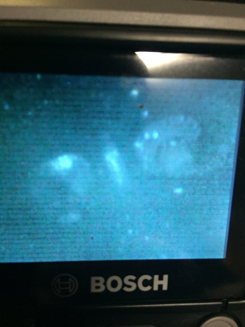

This is your valves now! And what they should look like
Attached Thumbnails Is this normal? (2007 R56)-photo244.jpg   Is this normal? (2007 R56)-photo541.jpg

I don't think any of the previous posts are relevant. You're looking at the milky crap that forms when the car never warms up thoroughly in cold weather. You're car needs a road trip.
