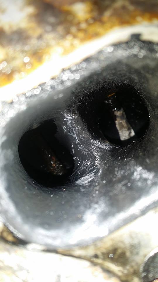

Old Mar 2, 2016 | 04:42 PM
  #39
Ninopr's Avatar
Ninopr
Joined: Apr 2011
Posts: 64
Update
Been taking everything apart and here's a look on my valves. Will be taking the cylinder cover off here pretty soon, just waiting on timing chain removal kit .

That's really not all that bad if we are talking shop! i've seen some pretty cake valves before.. but it doesn't take all that much, are you planing on redoing timing when you put it all back together. i would if i waz you.. best of luck .. keep us up to date with photo's

Yea , they have some coating , but not near what mine looked like. On the one pic looks like moisture or maybe a leaky valve steam , can really tell.
