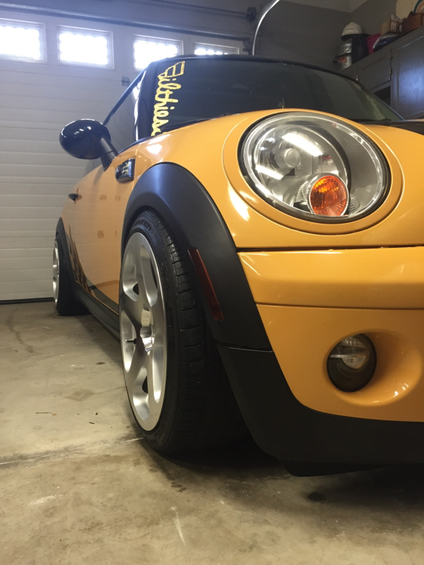

ECS, do you know if they go lower than the euro streets? I'm decently low, but I just didn't know if there was a difference between what the two went to. That picture is where I'm at right now.

benzoc,
your wheels looks really good! Congrats!
(I would give a chance to black Plasti Dip )

Originally Posted by miniuy
benzoc,
Hahah Thanks, I appreciate it. They were a B to find, but I found them thankfully. I ordered some wheel locks for them last week and put them on yesterday just incase. Don't really feel like taking the risk without them. But yeah I was thinking about black plasti dip but I feel like it'll take away from the design of the wheel. Maybe something different in the future. Possibly thinking of wrapping or plasti dipping the car balloon white and making the wheels white with Red,Blue,and Yellow splatters so they look like jaw breakers
Yes, the color will transform your wheels and the look for your car but you can hate or love the change.
Probably my taste for black wheels is affecting my comments heheh
However, your wheels (black or original) still looks amazing
Yeah I know hahah If I even consider going even lower I have to purchase some 16'' wheels. Who knows what kind I'll look into. I could go the cheaper route and go with some Whistler wheels as back-ups or get a custom size made from Rotiform if I choose. Reason being is I talked with a guy last night who took off his lock collar and his lower adjustment collar on his coilovers only leaving the top collar that the spring sits on. It completely dumps the car out. Only problem is MINI's are notorious for turning "evil" when dumped out too far and like to snap drive axels. Come spring though I'm pulling the side stripes off.
