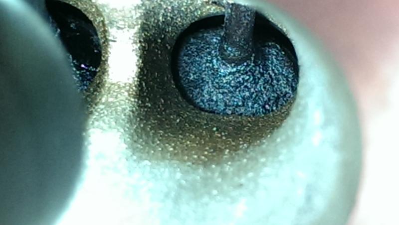

Carbon build up not helping
Just had cyl head replaced 22k miles ago. Never had an carbon issue before. Not sure why now. 22k miles and so much build up doesn't sound right. Could something be making the carbon build up worse and build up faster?
