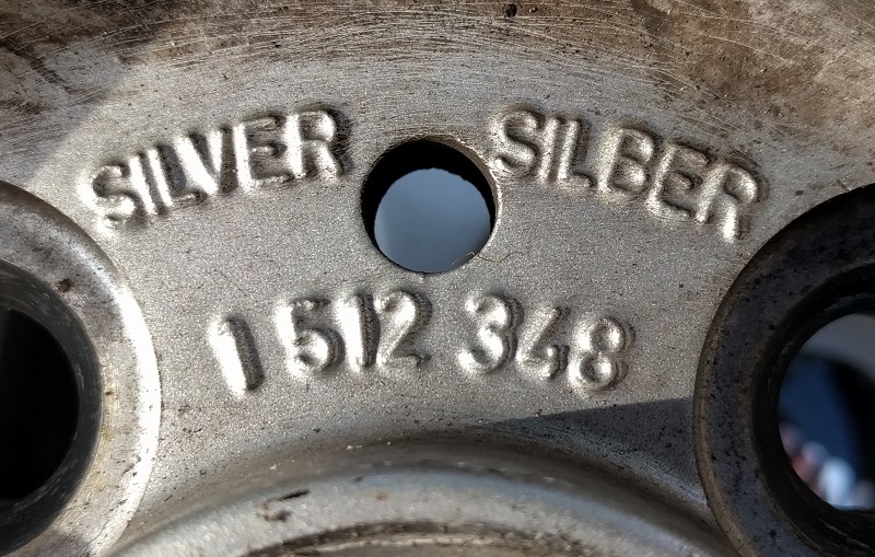

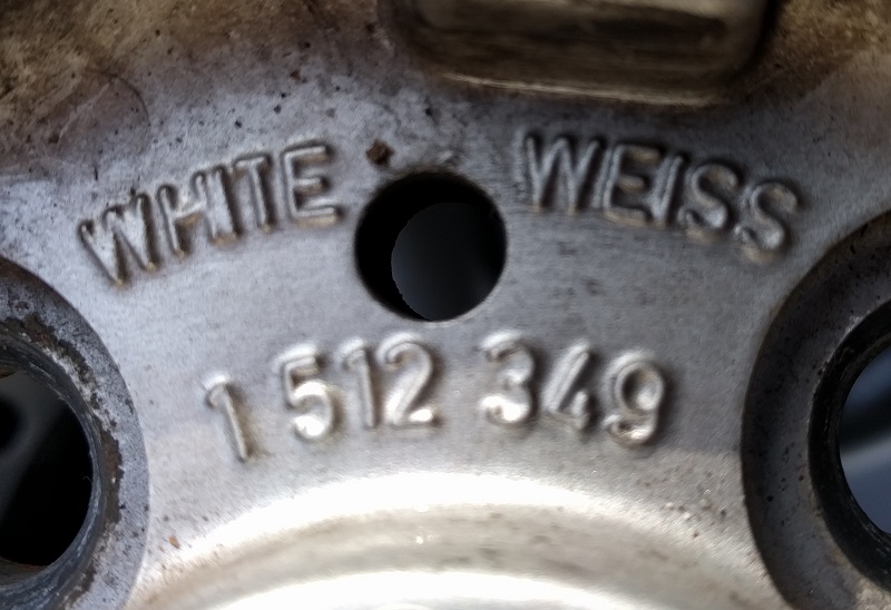

Yea, I think its was an OEM sensor on a newer part number wheel, in 2007 MINI changed part numbers on allot of gen 1 OEM wheels . We compared the bodies and the huf orange is smaller and little bit less broad on the shoulder to the head of the valve, thus should be able to fit more. Whats the part number on your OEM wheel, it might have the 7 seven digits or 5 digits stamped into the barrel or on the back wheel spoke, or near the back where it meets the hub. Take some pics , post up..... we will get to bottom of this strange and only 5 people know in the world questions.

Wheels aren't at my primary residence, so it was tough to get pictures, but this is what I've got. The first one is (I think) what the wheel is made from. The second and third don't look much like BMW part numbers as they're too short, but it's the best source I found. There is what appears to be a date stamp on the wheel though, and I think indicates that they were made in 2002. So if there's a revised version, these probably aren't them.
Yes, they need a cleaning.

Posts: 36,723
Likes: 2,537
Thanks for that.
Yes, the parts numbers for this one did not change , but yes , its older and most likely way before the tpms re design.
