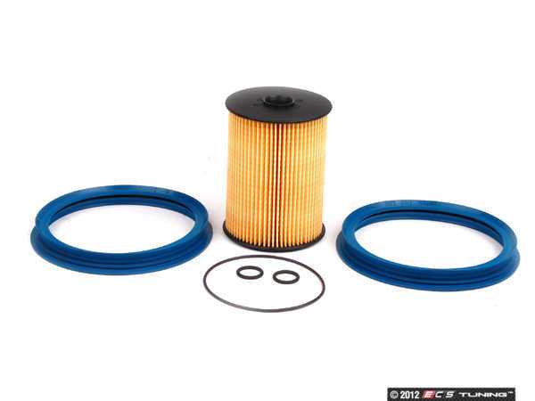

Dependent on miles: Fuel Filter
Here is a fuel filter DIY .
The fuel filter sets on the rear right hand side of the tank.
Fuel Filter Kit part number 11252754870
http://www.ecstuning.com/Search/SiteSearch/11252754870/ES21420/
#2 in the diagram.
