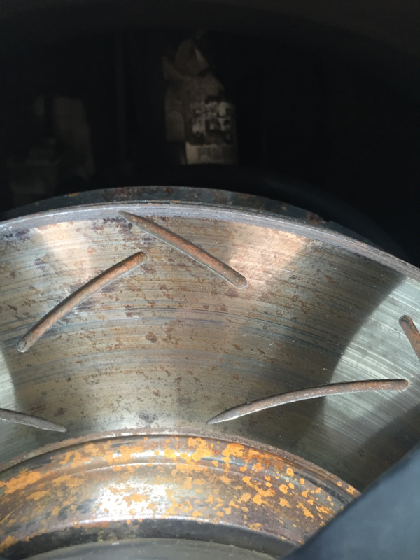

Can someone confirm what these water mark looking spots are(not the rust). These are new rotors and just want to make sure they're not high spots.
They have been on the car for about 150 miles, so they're not entirely bedded. The other side of the car doesn't have this on the rotors, so I'm a bit concerned. Sent from iPhone

Originally Posted by micromini234
Can someone confirm what these water mark looking spots are(not the rust). These are new rotors and just want to make sure they're not high spots. They have been on the car for about 150 miles, so they're not entirely bedded. The other side of the car doesn't have this on the rotors, so I'm a bit concerned. Sent from iPhone
Is this the side of the car that faces your sprinklers ?
If so may be hard water or simple corrosion

I don't have any sprinklers that would hit my car; where I park it.

looks like what rust marks look like after you rub off the loose orange crud. Your pads should scrub the dark marks off if they are contacting the rotor properly. Try hitting the spots with scotchbrite.
If your new brakes are not bedded by 150 miles, I am curious as to what your break in procedure is

I would not worry about it
I see NOTHING unusual here . .

Except for the rust on the hats. But that's what you get with uncoated rotors...

Yea, looks like someone sprayed water on them briefly after you parked the car. Surface rust. Yea and there not coated so the hat and edge are rusty.

Thanks for the replies guys.
When I'm able to get back on the road. I'll take it for a real drive on the highway and see if i can't get the rotors to clean themselves. Sent from iPhone

They don't appear to bedded, they're ebc reds. 150 miles is what it said on my odometer and I have no idea when I hit the reset, so it is very possible I haven't put that many on it.

My bedding process is 5 stops from 40 to 10 mph pretty quickly do not stop the car u do not want to create a hot spot that 5 stops from 35 to 5 than a quick highway run to cool them off and your good you'll Snell all the crap burning off

Bought mine CPO so no but I am a technician and do it on all my brake jobs helps to elimanate any rotor noise before the customer drives it too

minivinnie92---sounds like a good bedding procedure to me. I work on Police vehicles for a career, and I do something very similar. But, I do it twice, first after install, then another after a complete cool down. And to the OP, I say more driving is in order. I see no issues so far.

Ya unfortunately a lot of times the customer is waiting and I don't get that luxury of a cool down the most important part is to not stop the car when they are that hot to u don't create a low spot

Another thing that has happened to me personally when stopping with hot brakes and holding the pedal on? Pad transfer. Makes for a rough spot on the rotor, which will lead to a pulsation in the brakes. Hard to bed brakes properly, but it must be done.

Ya well that's the thingwhen they are that hot they will imprint on the rotor so if I have to stop I try to use neutral and roll to a stop
