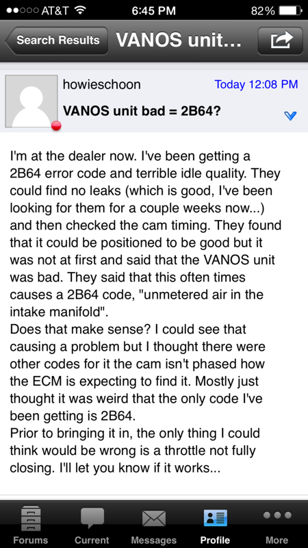

The pic is clear on a computer. Yeah I see it is blurry on my iphone.
https://www.northamericanmotoring.co...es-please.html
I was just trying to show you another post by Howie (link above) that
talks about how he had a bad VANOS solenoid and replacing fixed his issue.

dawgscj7,
Did you try cleaning or replacing the VANOS solenoid valve?
It appears this fixed the issue for another owner.
I see you have more codes than just the 2B64 but it may be worth a shot.
