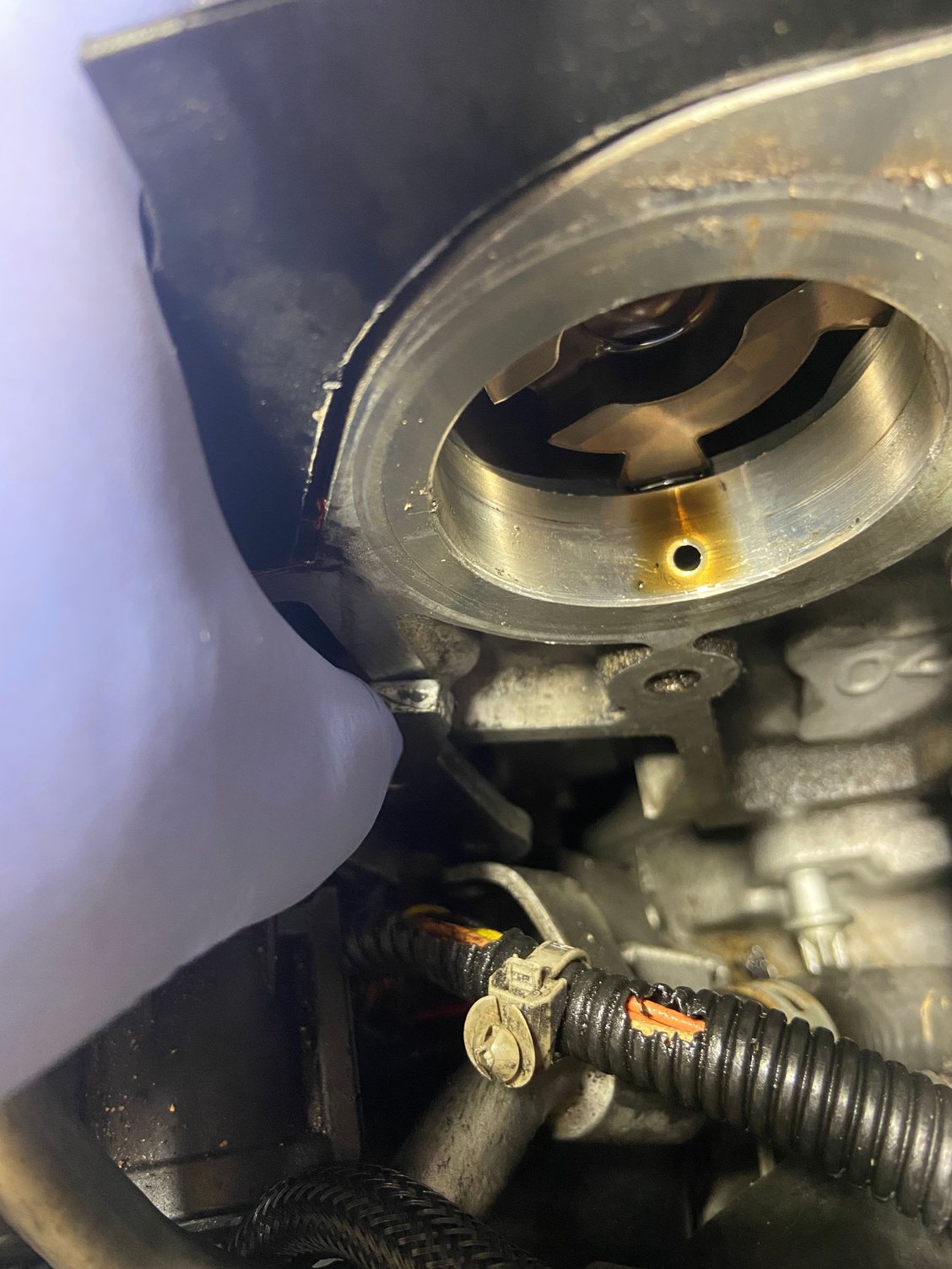

The oil hole in that stoooooopid vacuum pump is tiny. If that gets clogged or your oil level drops for a significant time its not surprising it would lock up and destroy the head. French motor...
I took my pump apart and uploaded pics on this forum. Look for it.

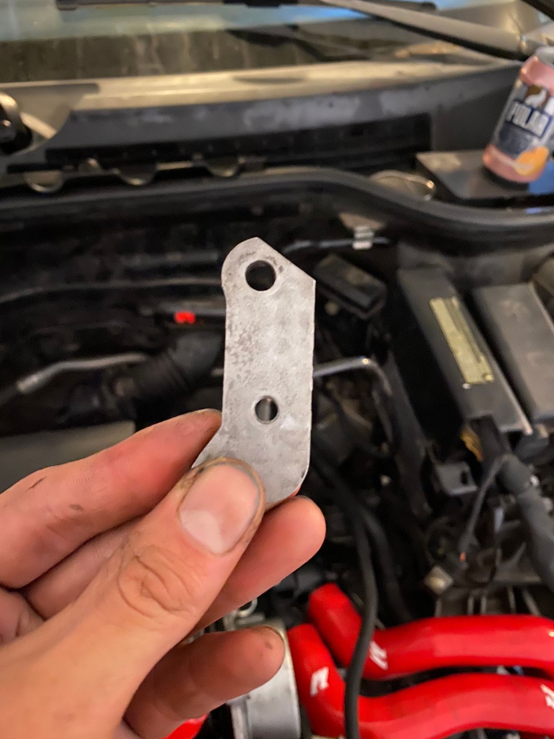

I'm going to take a long shot and reply to this seven year old post. I have a 2010 Mini Cooper R56 N-14 turbo, and I'm doing a DYI vacuum pump job. I've watched every available YouTube video on how to do this multiple times. But nobody in any video ever mentions the "turbo water-line support bracket." This is the only how to guide that I can find on the internet that does. I have enlarged and enhanced the photo on this post, but for the life of me I cannot figure out where this thing goes. Unfortunately since nobody else in the YouTube videos has these, I wasn't expecting it and clink it fell down the engine when I removed the left bolt but I was able to recover with a magnet. Therefore, I do not know how it was sitting. If anyone happens to see this reply and knows, I would very much appreciate it. Thanks!

Thanks for replying! Here is the part that I'm trying to determine how it attaches. https://www.ecstuning.com/b-genuine-...e/11537568433/

Thanks buddy, I appreciate you trying to help. I've seen the diagram from your earlier reply but unfortunately I still don't quite get it. Because I only removed the two screws from the vacuum pump, I'm not sure if this bracket was actually serving any purpose anyway. I assume that since one of the holes on the bracket is threaded (not the hole that the screw goes thru between the vacuum pump and engine block), something was supposed to screw in there. A third screw. I don't think I dropped anything else since I was using a magnet, but it's possible. Or maybe something had already been disconnected from the oil leak coming from the pump. YouTube has taught me how to replace the valve cover, coils and plugs, and oil change, so I thought I could handle this too.

I think I figured it out
Ok, so I'm holding the bracket in place with my thumb as to where I think it belongs. Since it is a "support bracket" and there is a screw hole on the bracket directly in front of this one, I just push a screw thru both brackets and continue with a screw above that one which goes through the support bracket and the vacuum pump. Maybe I'll put a nut on the other side of it to keep it from falling out. As you can see, I've got some bare wires too. How do you recommend wrapping these up? I guess it has to be heat tolerant cause she gets pretty hot under there. Even in the winter! Thanks again. This is a great message board.

ok so you have the bracket holding the other bracket yes? That's what the parts explosion looks like...looks correct hommie. Me like.
Wrap those exposed wires in a ton of electrical tape at the very least or a piece of hose or something over the worn section and then some electrical tape. Glad you caught that before it shorted out.

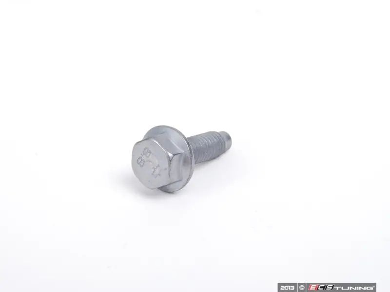

Just looked at this on my MINI, that bottom bolt is:
https://www.ecstuning.com/b-genuine-...t/07147543920/

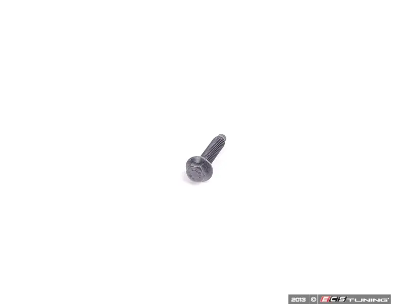

The top bolt that goes to the vacuum pump connection is this:
https://www.ecstuning.com/b-genuine-...w/11427527412/
