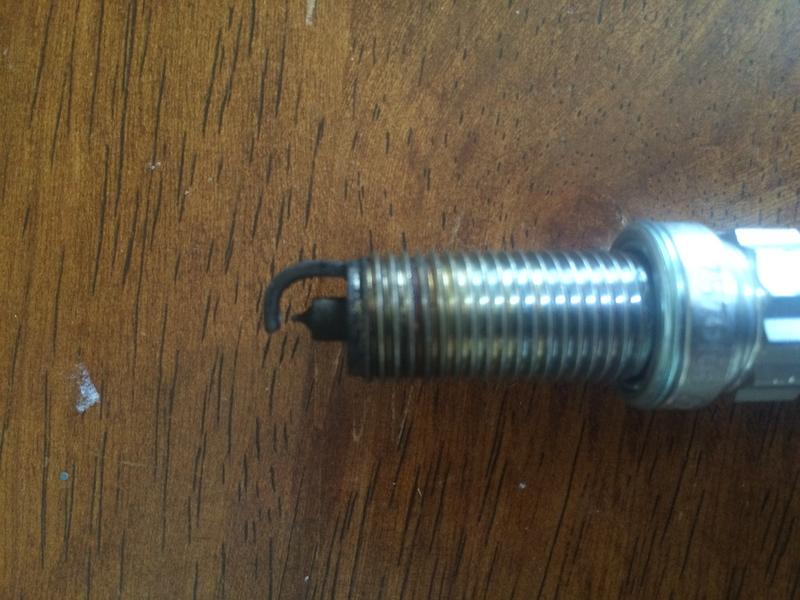

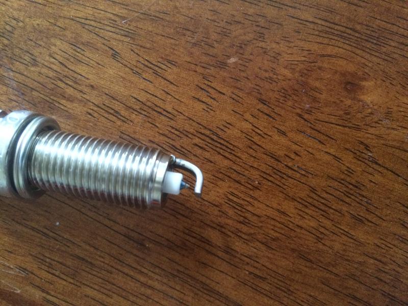

After checking and replacing all 4 spark plugs, cylinder 3 was by far the worst. Just black and sooty whereas the others were more normal-wear-looking.

A pic of the spark plug from cylinder #3 vs new:
