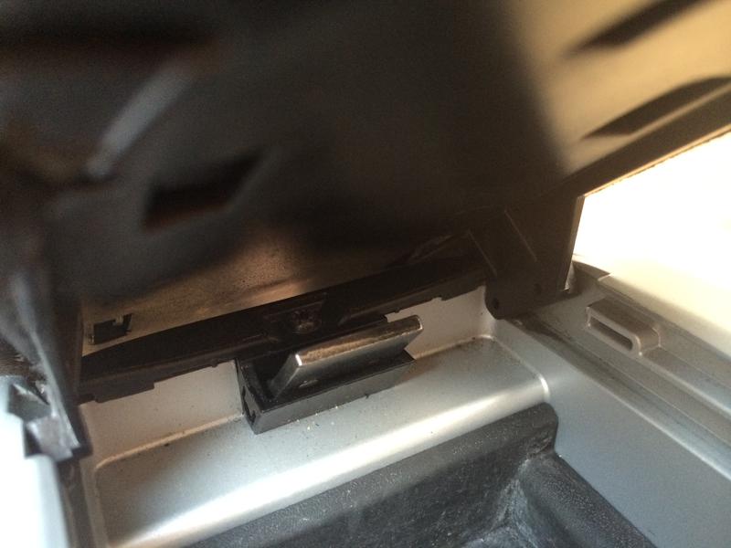

and you should do this at the very back of the armrest because there is also a second track above that one ...these pegs slide in the lowest track.
Old Mar 13, 2015 | 10:33 AM
americo11's Avatar
americo11
Joined: Feb 2015
Posts: 232
From: Rhode Island
this is with the cover flipped back

Got it, thanks a million! You do have to squeeze the pegs together until it pops in, and sort of shove the front end down to get the upper set to pop in. That's the last time I take it to a freaking car wash.
