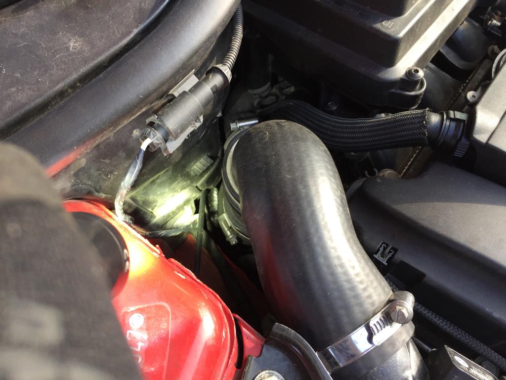

I walked around to the passenger side to peek around and try and find any signs of leaking fluid, and I noticed a woven-shrouded hose of some kind just to the right of the flashlight's spotlight in this photo:

I talked to a guy at MINI of Louisville, and he was pretty nice and helpful. While I'm a little miffed about the airbox not being reattached properly, at least this is probably what is causing the P2177 error code for lean off idle.
There's a puddle forming on the passenger side. And there is some sort of liquid all inside the front passenger wheel.
So it's probably a fault with the water pump. I may try to fix it myself and see if that solves the problem. The thermostat is still covered under warranty if it continues to be an issue.

Look at the 'how to' article on thermostat replacement (in the modifications section) and learn how to bleed the thermostat. I can describe the location of the bleed valve, but a picture is worth a thousand words, especially in this case.
The oil filter housing has an oil cooler bolted to it, and coolant runs through both of these. There is a seal between the block and oil filter housing, and another gasket between the oil cooler and oil filter housing. These are a common failure point on older 2nd gen MINI's. If you see wetness down the front of the block dripping on the downpipe (where it turns under the oil pan), it is probably these seals.
The water pump is a DIY job, but it isn't much fun. The stock water pump has a plastic housing, there is now a metal housing replacement. If you have someone do it (or do it yourself), make sure that you get the metal one.
Another place to check is the coolant resevoir. look on the bottom of the tank for signs of leakage (chalky blue/green residue) or cracks.
Have fun,
Mike
Old Feb 12, 2015 | 11:17 AM
Systemlord's Avatar
Systemlord
Joined: Mar 2013
Posts: 3,428
Likes: 37
From: Mission Viejo, CA
If you're getting coolant in the passenger area the water pump is the first suspect.
