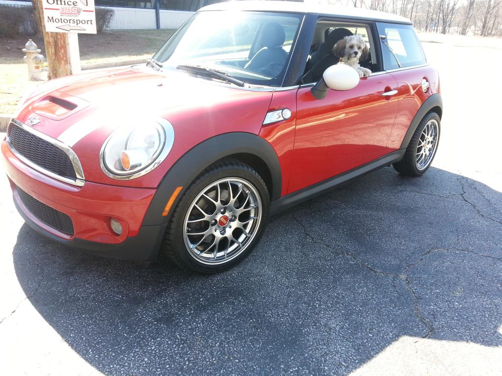

Got her back on Friday
Mechanic said the DMF was shot...
$2100 repair including new oil filter mounting gaskets and oil lines to and from the turbo. Stock clutch. Drives fantastic and to celebrate I got some new wheels/tires and an alignment. 17" BBS RGR and Pilot A/S 3 Next up is a RSB.
