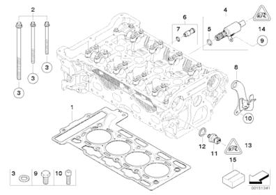

Here's the screen from RealOEM. Poke around there if you haven't done so yet.
Oil pressure sensor is shown on the front left drivers side (right side of the screen here) Item #11. Part # 12-61-7-568-481.
There is a special sealing washer used- it is an aluminum crush washer that also has a center rubber seal on it. Part # 12-61-7-546-239.
It resides in front of/above the thermostat housing and below the exhaust vacuum assembly on the drivers/left side of the cylinder head. It may be tight to get a wrench in there. It takes a 22mm (a 7/8" will also fit). With the wire connector off, the grey plastic part of the sensor sticks out about 30mm, so a deep socket may also fit. Be gentle on removing the connector- it seems every connector on the MINI uses a different method to release. Some squeeze, some you press a single release tab, some have 2 tabs, etc...
Recently, I found our pressure sender was fairly loose. Only took a light nudge on the wrench before I could spin it out.
