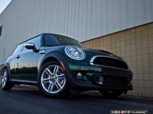

16" factory wheel options. Many styles.
http://www.ecstuning.com/Mini-2009-Cooper-R57-S-Convertible-L4_1.6L_N14B16A/Wheels/OEM_Alloys/
