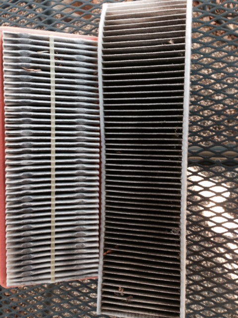

2013 MCS
1. Tire rotation. MA said Mini didn't rotate runflats. Despite finding no reason not to, I said nothing. Result: front tires gone in far too few miles. Good part: I ditched the runflats and put on Michelin Pilot Sport A/S 3. Rotated regularly (as runflats should have been). Way better drive.
2 and 3. See photo. Cabin air and engine air intake filters at 30,000 miles (2 years). Yes, those are chunks of stuff you see in the photos along with extreme particle load. No mention at service and when I asked got vague answer as to when due. Should be no more than 15,000 mi/ 1 year; more in dirty driving conditions.
At least I used my brain for oil/filter changes: every 5,000 period, despite I pay for every other one (and OCD change at 1,500 miles)
Next oil/filter change will include gas filter and maybe tran oil and.......

They aren't that bad. The cabin filter is a grayish black color anyway.

I used to laugh at jiffy lube every time they walked up to me with a air filter a little dirty, I say well it's doing it's job, stopping dirt, if it was clean then is would be a FAIL. A little dirt is normal so long as it's still flowing air.
That cabin filter looks like it came out of car that has 4 2 pack a day smokers in it, Mine never looked that bad after 2 years.
