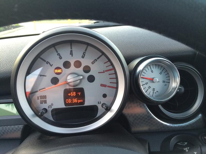

From: Cleveland Ohio
Originally Posted by blunderbird
you didn't answer what brand of gauge. there is a big difference in accuracy between a $20 vato zone and $100 auto meter...
I have an Marshall Instruments boost gauge.
