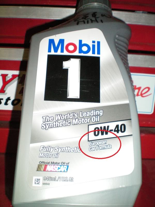

since 2003 I used Mobile 1 'Euro formula' and OE filters with never a problem - for the folks I do oil who bring me there cars, I use what ever filter and oil they bring . . .
