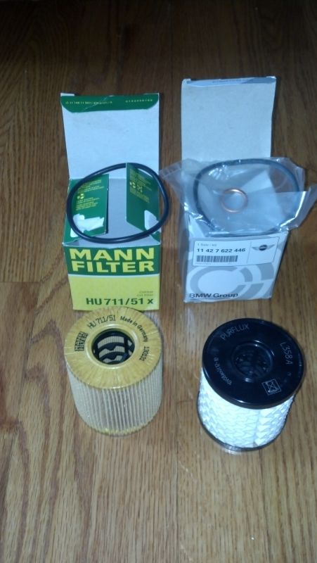

There are at least 2 safe options that I've used (there are many others, do your homework):
- Purflux OEM filter (from the dealer) - made in France, part # 11-42-7-622-446. Should run you around $10/each.
- Mann (OEM for BMW) - made in Germany, part # HU 711/51x. Should run you around $6/each from Amazon.
I have both on hand. Will post a picture of the two if I figure out how to append it to the post. If not, Google for them.
Both filters look solid and work fine. I've used both.
When ordering online or over the phone, make sure you specify the last 7 of your car's VIN, or 2x check by other means that they part you are buying will fit your car.
a

crush
I don't see anything on the Mann one about the Crush washer? I would have free shipping as I have Amazon Prime so that would be awesome, but what about the crush washer?

I don't remember if the Mann came with a crush washer or not - it's my last one off the 6-pack I bought years ago.
As far as crush washers go - new are nice, but you can safely reuse old ones, unless they are damaged. I prefer using new ones if they are on hand, but never had leaks when reusing old ones as long as you tighten the drain plug to spec.
a
Old Apr 18, 2014 | 11:01 AM
Posts: 36,762
Likes: 2,551
The Mann HU 711/51 one is above in our link , they don't come with the crush washer. I linked it for you. OEM and aftermarket, just one needed per filter.
