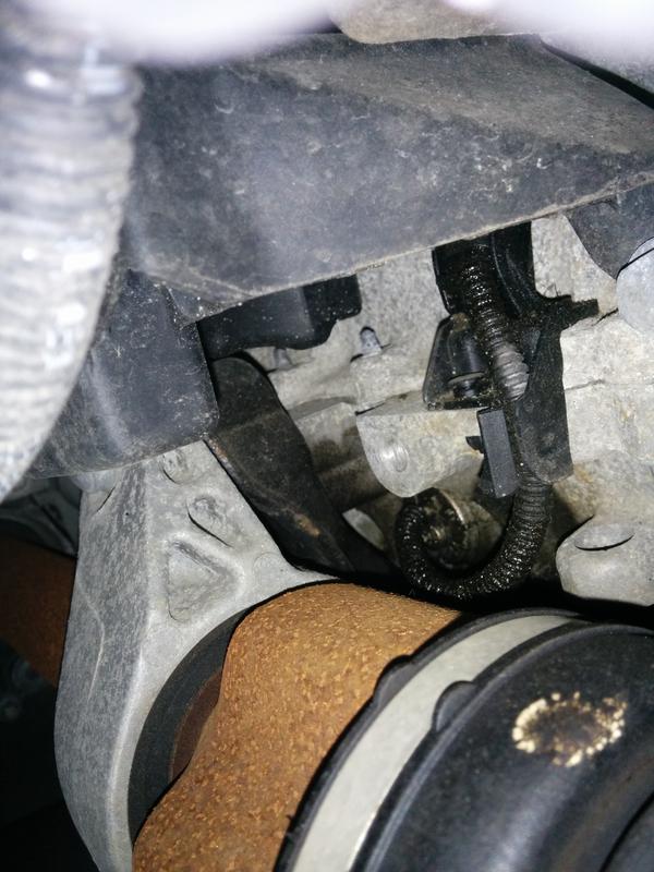

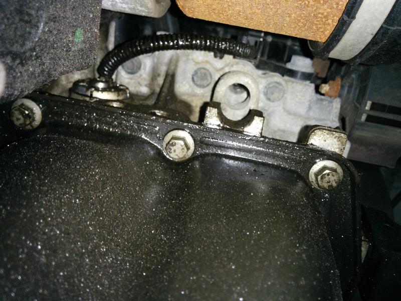

This is what the solenoid leak looks like in its early stages...
Eventually the oil will start to drip off the pan on to your parking spot.
Pix taken from below and to the side from the passenger side.
E
Attached Thumbnails can anyone help me?-img_20140729_085024.jpg   can anyone help me?-img_20140729_084735.jpg

By the time mine looked like that, I was going into limp mode every few days.
