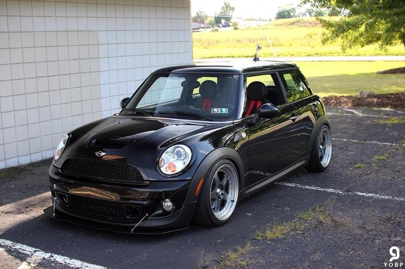

performance wise just catback straight piped, hot side boost tube, and a intake. this is how the car currently sits though. Dont think exterior components would void it since it has nothing to do with the problem right?

First of all, that's a sweet-looking Mini.

Thanks man! And there actually isn't a P.O. I did all the work to the car. I do have factory parts but I can't do anything about the exhaust as straight pipes are welded in. Everything else I can return to stock besides the coil overs
