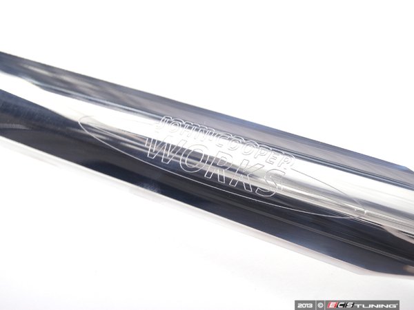

The JCW strut tower brace with fit your R56 Cooper ( Non S ) with stock airbox. I don't know about the aftermarket ones.
http://www.ecstuning.com/Search/SiteSearch/51710442352/
Dont forget the strut nut. 3 on each side. So 6 total. Part #07119904295
http://www.ecstuning.com/Search/SiteSearch/07119904295/ES14543/
