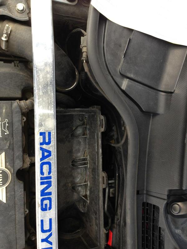

The modification seemed to work well, and I haven't given it a second thought since 2011... until last week when I was driving down the highway (in 4 degree F weather!) and thought I heard a noise from the engine compartment (wasn't sure), after which, the "feel" through the gas pedal changed - the car become much less responsive, but still drivable. It would accelerate, but with difficulty.
The next morning when I started it, the check engine light came on, so I took it in to the local MINI dealership. I've attached the two photos they sent me, and here's what the dealership said:
"Hi it's Andy at MINI- the 1st picture is the zoomed out to show you generally where we are talking about. The 2nd pic is closer up and shows that open tube, angling down and to the right. This tube should have a hose connected to it to run up to the firewall to generate noise in the cabin. You are missing this tube completely. That is what we need to replace to correct your problem. Let me know if you have any questions!"
Sooooo.... here's the BIG mystery. WHAT THE HECK was done to my MINI in 2011 and HOW can I re-do it (quickly, easily, inexpensively) rather than have the dealership re-install the noise maker and pay the them $400-500??

Why didn't helpful Andy at the dealership take care of this?
Anyway, it would be helpful to know what the check engine code was. As for the noisemaker delete, it is a common procedure mentioned on this forum. A Dorman Compression part looks a bit like this,... is something like this disconnected now? A big vacuum leak could possibly cause these symptoms, but why did a mechanic at the dealer let you drive away with it like this?

Well the dealership still HAS the vehicle at the moment. They are suggesting that they sell me a new noisemaker and re-install it, all for about $450-ish, which doesn't make any sense to me. I'd rather have the modification re-done.
I asked about the check engine code, and they said, "oh, a check engine light can mean a ton of different things." So I never heard any specifics on that, but I just got off the phone with the dealership and they said that, yes, it is a vacuum leak. So apparently, something is now missing.

the pipe pictured in #2 needs to be plugged off. find a rubber cap at home depot or lowes and put a hose clamp around it. simple as that.

Just like bmx045 said. It's a leak, cap it off. You can replace the hose from NM with a different hose https://www.velocityfactor.net/Scrip...dcategory=2751 or you can get a cane or stool rubber piece from Home Depot with a clamp and call it a day. I can't the dealership wants to charge you $450.00 WOW. The code will go away in a few days. That happened to me. Good luck.

I agree with what everyone said above. What I'm worried about is where did the mod plug go???

Sure, Dorman makes a compression fit cap off plug, it must have fallen off. It is that simple to cap it off like the others said, you can do it. Go get your car from those guys and their $450 estimate.
