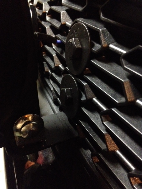

I've been meaning to post this.
I purchased the Hella 500ff driving lights and did not want to pay the $90+ for brackets so I made my own. 2 steel L Brackets, 2 nuts, bolts and washers for each bracket (4 total). and painted them flat black.
DIY home made brackets for under $5. They hold on tight with almost no vibration. I can take better pics when I get home.

Sorry for the bad Picture. I didn't have time to remove my grill this morning but you can get the general idea from the attached picture.
The L Bracket that I bought from Home Depot was this one:
http://www.homedepot.com/p/Simpson-S...-A44/100375040
It fits through the slots of the grill perfectly. No cutting required. However, I did cut and round off the bracket itself. By itself, it's longer that I wanted it to be.You don't have to do this, but I had the time and tools to do so. I hope this helps.
If you guys want more pictures, I can take the grill off tonight.

To me it's pretty stable. There is minimal vibration.I also drive freeways pretty frequently. I wanted to make a note that I also added blue loctite to the bolts to prevent it from loosening over time. The bolts attached to the grill are tight but are not over tightened. My intention was to make a cheap bracket for the lights. If they didn't work, I would be out $5 and I would by the VIP brackets. However, I don't think I will change these out. They do their job.

Just tried your bracket. I'm getting quite a bit of vibration granted my grill is cracked everywhere. It seems pretty strong though other then that it's all good.
