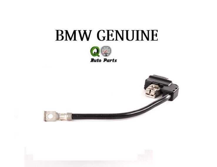

As long as the MINI does not have an intelligent battery sensor (IBS) there is no need to register the battery. It is the black plastic piece on the negative terminal & looks like the picture.

Any idea when they started installing those?
Any idea if this is located somewhere else?
