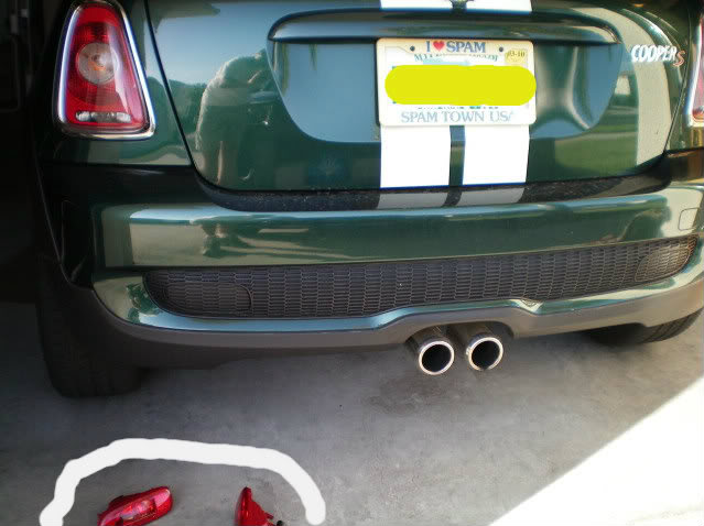

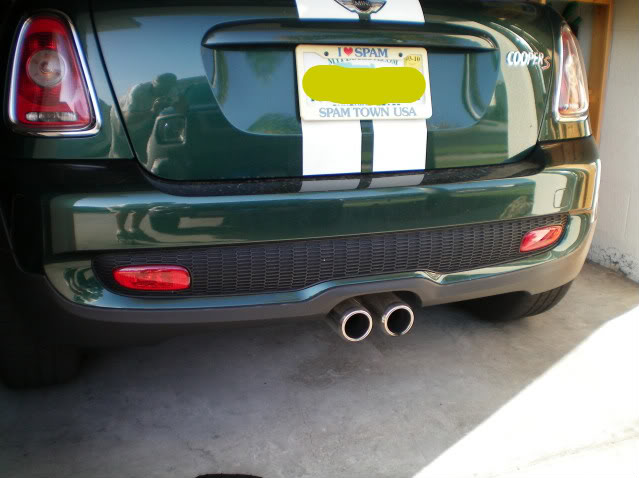

Anybody have any idea why anyone would pay for these options but not have them active?
I just sold my 7'S
I didn't like the plugs in the rear fascia so I put in the rear fog fittings.
elapsed time ... 3 minutes
I had no intention of paying for computer reprogramming to make them work .....
and my 7 had blu tooth buttons on the wheel but no blu tooth in the car . .
