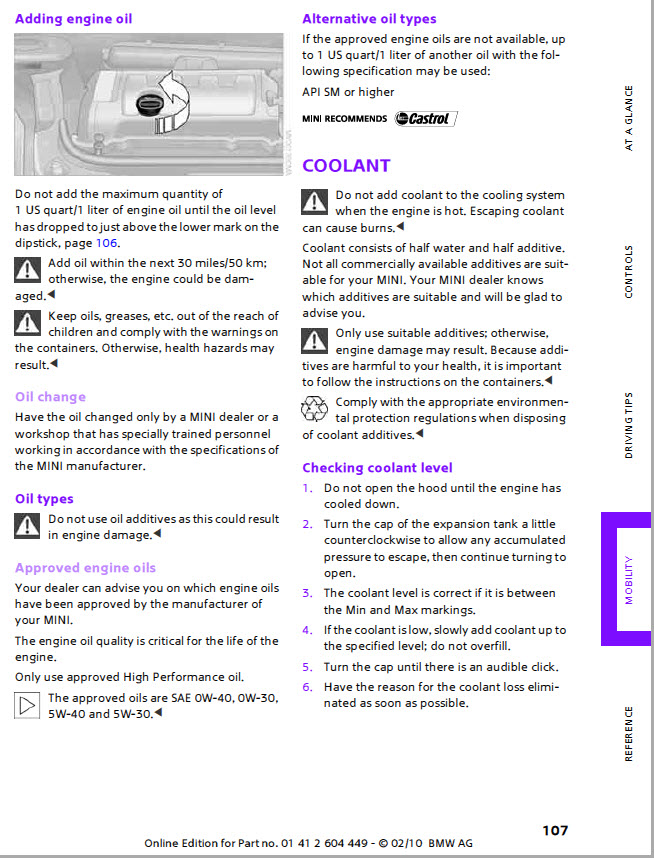

Consult the OM for oil recommendations. Last I read the only Mobil 1 that was allowed is the 0-40 euro formula. My current manual for my '10 is different than that I recall for my '09 where it only stated 4 oils and the spec required (LL-01, If I recall correctly). So it appears as if my current manual now allows more oils to be used and doesn't list the LL-01, just the API SM or higher if adding 1 quart or less.
