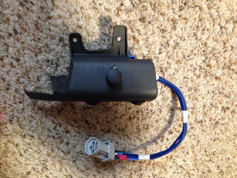

Thanks for the input!! I think I've decided to go with Piaa fog lamps and am going to mount them on the Outmotoring Mid light mounts (they sit the lamp about level with the bumper). I already made a switch panel on the driver side knee roll (see attached pics) which has my sub level **** and 2 toggles. I just need to add relays and battery power. I've put off some modding as we house shop so the wife and kids don't kill me as we try to move. I'll get it done eventually, just on hold for now. I'll definitely post some pics once completed. Thanks again for the input!!!
