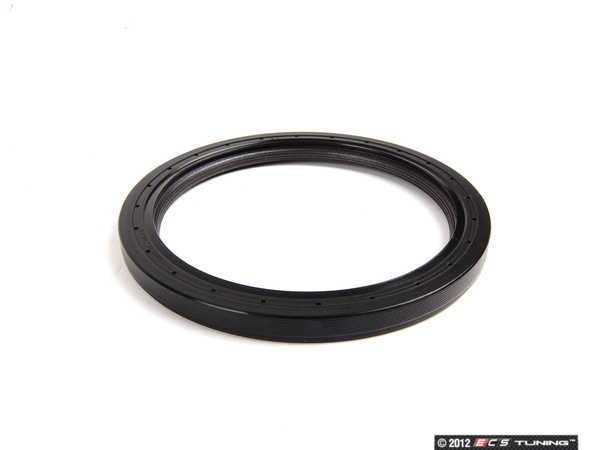

Main seal, I think you are talking about the main shaft seal ? #5 in the diagram?
http://www.ecstuning.com/Search/SiteSearch/11117568263/ES17765/
