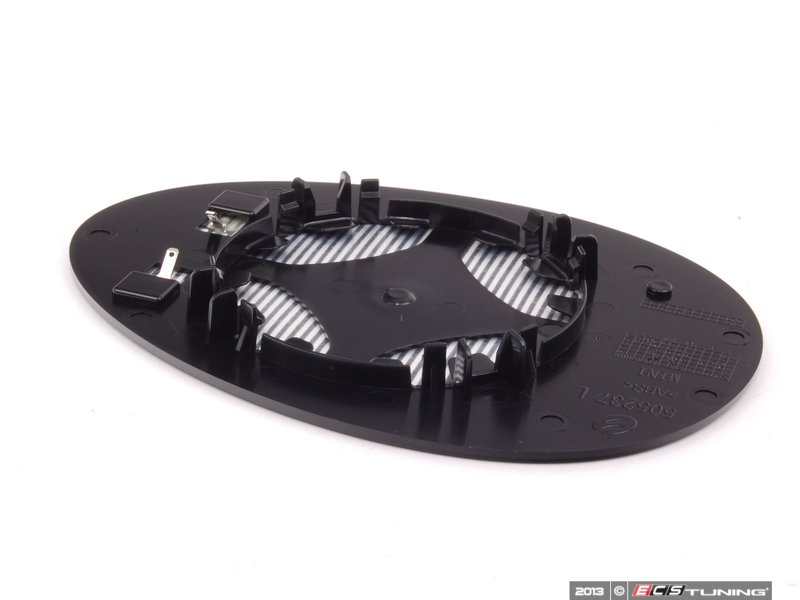

The prices I see online for the OEM mirror run $50-$70: http://www.ecstuning.com/Mini-2010-C...rrors/ES81929/
If you want to save some money through the eBay listing, I think it is relatively low risk and you don't lose much if it doesn't work out. Not a heated mirror, though.

The OEM glass is itself attached with adhesive to the plastic mounting piece. When you buy the OEM, you get the glass and plastic together and you only need to snap the part into the mirror housing.
Using the eBay glass, you'll separate the broken OEM glass from the plastic back, and reuse the plastic piece (attach the eBay glass to it). If the plastic piece is also broken, you need to get the OEM mirror.
