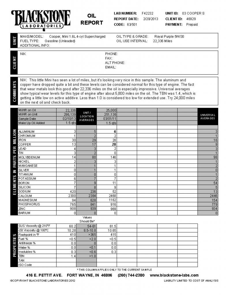

Gen 1 engine, but have followed the OBC since day one and at over 296,000 miles it is doing fine. Changes run from 15k to 25k. See two oil sample results below.
No water in either sample below, and hardly ever any in either of my catch cans.

About time someone put up something factual. Not sure I'd have chosen Royal Purple to go 20+ thousand miles, but it seems as though it worked well enough. Not expecting everyone to go 20k, but I think 10k makes the most sense even for people who like to be on the safe side. There is a point where changing it too early is just a waste of time, resources, and $.

I'm not sure how you can treat a single oil analysis chart from a DIFFERENT engine as some kind of absolute conclusion about your own oil change intervals... a fair comparison, yes, but not conclusive. For data to supercede logic, common sense, and anecdotal evidence, it needs to be a sound, comprehensive set.
Still, it costs me $45 for an OEM filter and 5 quarts of synthetic (when Advanced auto parts has them on sale). I buy my cars generally at 70-80k miles and keep them until 130k or so. I end up spending something like $225 over the entire life of the vehicle changing more often. People do this on the NA bmw vehicles, and the only real fair comparison (apples-apples) is looking at other FI models, and, for example, it seems most of the folks in the GTI forums emphasize good synthetic oil first, and frequent changes second.
I also find it amusing that when it comes to environmental concerns, the concensus seems to be to treat the mini like a race car (delete cats, delete pcv, straight 3" pipe, etc.), but suddenly when its time for an oil change, it's back to being a DD and we can just change every 15K... convenient.

From What I can tell that was an analysis from an MCS, Furthermore I never said that I would go that long on an oil change, my point is oil can last way longer than the 5000 miles that many are doing here.

It is still more data points than the "logic, common sense, and anecdotal evidence" used to justify not following the manufacturer's recommendation (which is likely backed by tons of data points).

The chart I included above shows the results of two samples. Yes, its from an MCS, but it is the first gen. But I think the point is still valid, synthetic oil last longer than 5k.
My 97 honda had 7,500 intervals on conventional oil
My Toyota FJ has 5,000 intervals on conventional oil
My F350 V10 has a 5,000 intervals on conventional oil
10-15k on synthetic seems totally reasonable. I decided to follow the OBC interval because I drive a lot and don't really like changing the oil every 6 weeks or so. I have had both the oil pan off and the valve cover off (to replace weepy gaskets) and found no build up of any kind. Everything looks like new.
Basically do what you are comfortable with.
